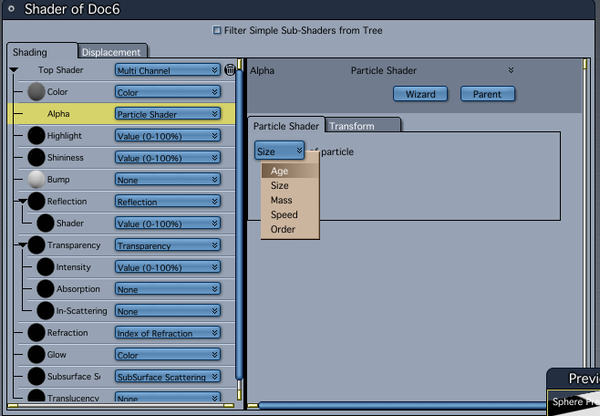

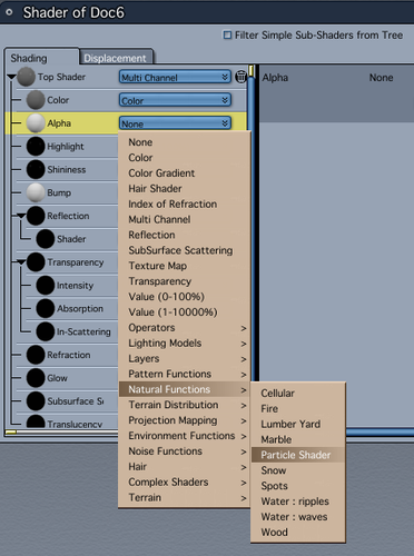

    I can't help with all of it, but as to the particle shading there is an option you can enable in the emitter editor to use particle shading. You would then go into your shader and enable the particle shading option, which in turn gives a few options on how you want to define the effect. You can even transform the orientation.
    Using the alpha channel as an example, you could put a color gradient with black at one end, and white at the other, then use the particel shader to define the parameters. Using age, you could set it up so that older particles fade away.

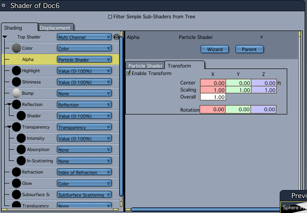

    Thanks for that input. I see in your last screen shot that "Enable Transform" is on. Any particular reason?
    I think I'm onto something else: I experimented last night by putting a particle emitter inside the geometry that I wanted to fill up. The geometry was made invisible. Metablob particles actually did the job. I still have to tweak it as it still looks a bit crude, but indeed the object "grows"
  • evilproducerevilproducer Posts: 9,031
    Just so they options weren't grayed out. I didn't have that applied to anything.
