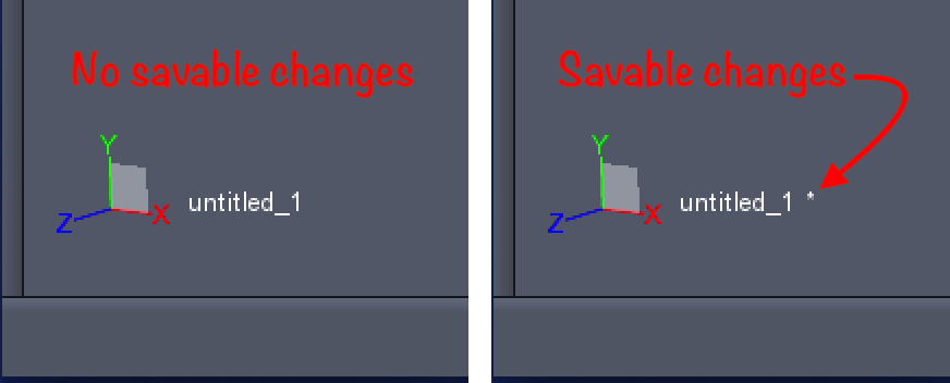

It appears that Hexagon doesn't recognize an object name change as an actual change in the file, so it doesn't actually save anything when you perform a Save. The time stamp on the Hexagon file doesn't even change, indicating that no Save actually occurred.
You can tell when Hexagon thinks changes have been made by the asterisk it places after the file name in the lower left corner of the screen. After a save is made, the asterisk is cleared until another savable change is made to the file. You can force a save by toggling the visibility of a single object. The asterisk will appear letting you know that the save operation will be effective.
