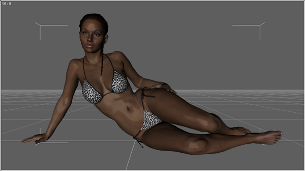

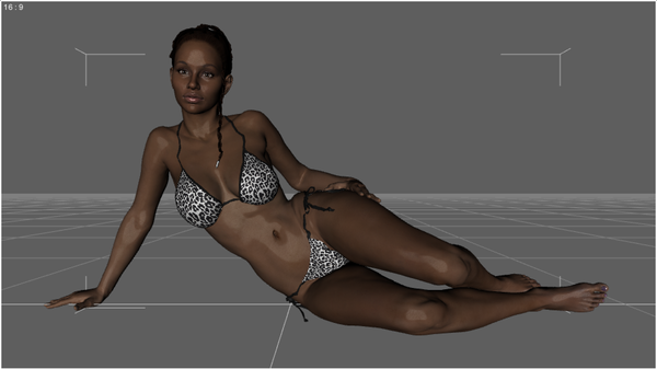

Hi all, I have a simple scene with Olympia posed and wearing the V6 String Bikini in it. When I save the scene and reopen it, The bikini is all deformed like when autofit makes a hash of certain conversions, you can also see it doing the same thing to the hair - any idea why?! See pics attached.

    I've never had this happen with the V6 string bikini (which I've used a lot) but I do have a similar problem with boots, which are shredded when the scene is restored. I'll be interested to see what the other guys come up with in response to your thread.
  • Richard HaseltineRichard Haseltine Posts: 111,380
    I think some people who have run into this have found that fitting the clothes to None and then back to the figure they should be on fixes it. The issue seems to be fairly rare so if you could submit a bug report it may help the developers to deal with it.
  • Silas3DSilas3D Posts: 835
    I did try that and didn't work. I'll log it as a bug report but if anyone has a workaround in meantime it would be greatly appreciated! I'm on a mac as well.

    I have just tried it with the same pose and clothes and got the same problem. It also seems to happen with other clothes and poses.
    After further examination, I noticed that some additional hidden morphs were applied to the clothing when reloading the scene (only happens after closing DAZ Studio though). You can see them if you enable "Show Hidden Properties" in the properties tab. If you set them back to 0, the clothes return to their original shape.
    This is probably a bug though so there is not much you’ ll be able to do apart from contacting DAZ support and let them know which items/poses are causing the issue :(

    I found the same thing Jaderail - however, have just downloaded the new General release and its not happening there! Whoop whoop!
