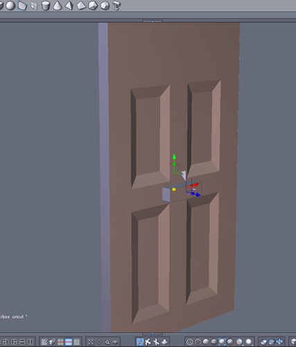

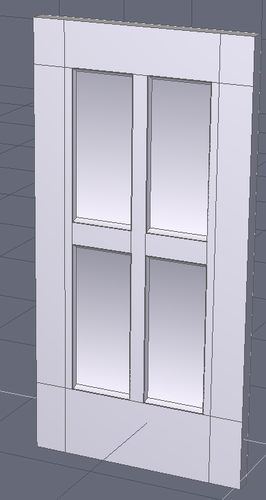

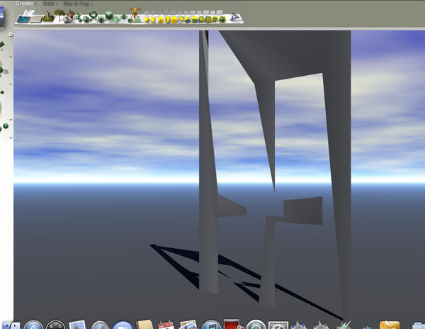

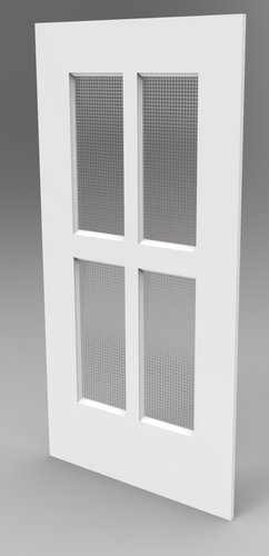

hope someone can help i am modelling a simple door and i am having issues when cutting a hole for the letterbox the following 3 pictures will show what my problem is.after cutting a hole in the door the geometry seems to be badly effected which is visible when i import the object int bryce.
first picture before i cut the hole
second picture after i cut the hole
third picture is the results in bryce
1260 x 975 - 331K
631 x 954 - 166K
802 x 939 - 99K
  • frank0314frank0314 Posts: 15,115
    I don't use Hex so not sure about your fix. In my app I'd have to add in more poly around the hole to reinforce the shape. Are you beveling your edges?
  • dot_batdot_bat Posts: 373
    why bolean the hole? its a simple rectangle, cut out the mesh for the hole
  • RoygeeRoygee Posts: 2,247
    What dot.bat writes is correct - but there is a lot more to it than that - the geometry of the whole door is all wrong, with n-gons all over. I'm surprised Hex managed to export the .obj without crashing.
    Trying to figure out how you managed to make the inset panels without edges connecting to the outside edges - unless you dissolved them after making the panels?
  • aliendoughnutaliendoughnut Posts: 40
    Hi The pic doesnt show all the lines! i used teselation by slice to mark up the door where the door panels are located with a pic of the door behind to get the lines in the correct position, i then selected one of the panels using the face selection and used the line tool to extract a line inwards to create the inside edge of the panel then selected the face and moved it inwards to create the final effect. i deliberatly didnt remove any edges incase this was causing the issue

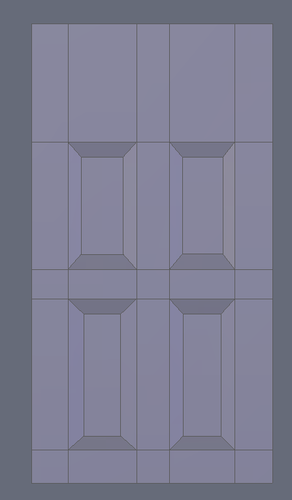

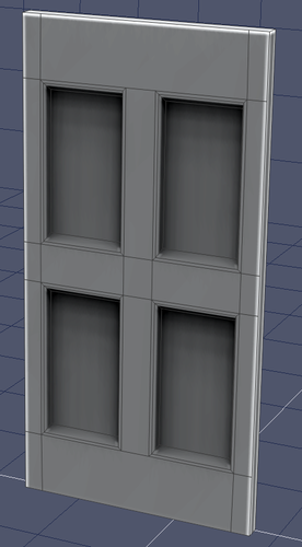

    If you have the wires something like this you should be ok in bryce.
    593 x 842 - 45K
    edited February 2014

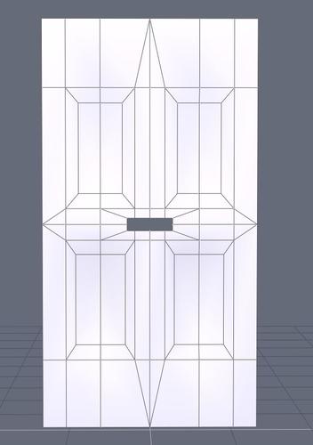

    mine looks like this without the letterbox cut out am i doing something wrong?
    447 x 765 - 18K
    Post edited by aliendoughnut on
  • GhostmanGhostman Posts: 215
    Looks ok to me. Only thing is the boolean. Stay away from it if you can when modeling in Hex.
    Bryce is really good with Booleans so you might wanna do the hole in bryce instead.

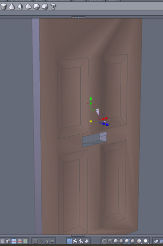

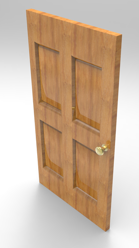

    Something you may want to try for making the hole is what I refer to as "fake boolean". Cut in the edges you need for the hole - make sure they loop all the way round the model - select the front and back faces of the letterbox hole and bridge them. Makes a really neat hole without the hassle of boolean.

    to me the easiest way would be to use lines and the first option in edge tools under vertex modeling tab.
    with a flat rectangle as the base, I'd select the top and bottom horizontal lines, and using edge tool to extract along and create some new lines. then I'd do the same with the left and right vertical lines, etc. Then finally once I had my 4 rectangular boxes in the center, I'd select all the rectangles lines and reinforce it with a thin extract along (i.e. a box within a box) THEN I'd select the face and do an extrude surface (or two, again, to reinforce the lines).
    This is the easiest and most efficient way of doing it, especially when it comes to limiting the amount of vertices/faces for rendering performance, and to ensure your geometry doesn't get messed up in case you need to manipulate it, since the extrude doesn't depend on the outer lines for reinforcement.
    Ending up with something like the attached photo I've included.
    I've also included an alternative door with a different line structure to show there's more than one way to do it and that not necessarily everything needs to be reinforced through dividing them up into smaller sections.
    Get used to using lines and edge tools, it may be more work than boolean but it is a heck of a lot more stable and allows you to perfectly align things easily. You can typically do these things as fast as you would using boolean. You can also use these lines to create grooves between sections to give the appearance of an assembled object and a more robust detailed model.
    622 x 1284 - 255K
    389 x 731 - 41K
    734 x 1312 - 646K
    452 x 818 - 137K
    Post edited by useroperator on
