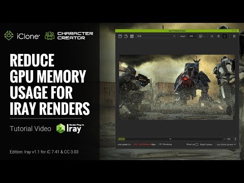

    It doesn't seem Iray is 'smart' enough to compress textures further from the camera. Interestingly Iray for iclone gives users some more options for selecting exactly what gets compressed more. So you can manually select an item away from the camera to be more compressed and save memory. It would be cool if Daz Studio could adopt this.
  • marblemarble Posts: 7,501
    That's interesting and probably the kind of thing I was trying to get at with my question.As you say, if it is possible in IRay, I hope DAZ get around to implementing it.
