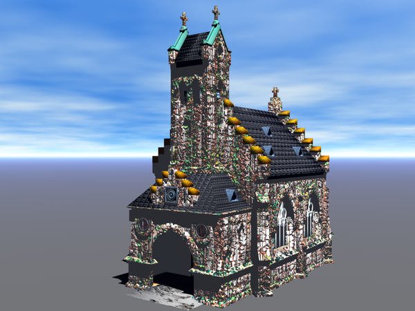

    I finally found a place where I could download Meshbox, several versions really, but only one seemed to work. I say seemed until I imported one of the converted models into Bryce. It was an .obj file, but still blown apart. I don't know if the original file had an exploded model or if it occurred during downloading. And one of the converted models was missing both end walls, where it didn't originally. For what I want, Meshbox doesn't seem to work.
    I Googled again for other file converters and found Ivcon 3D Conversion, but haven't tried it yet. On a forum someone asked how to convert a graphic file and someone suggested, are you ready for this, Wings 3d. Well, that would make sense because Wings can import .3ds and export .obj.
    I imported the exploded, freebie, church into Wings and saw it wasn't as bad a reconstruction as I first thought. So I spend a couple of days, off and on, putting it back together, and imported it into Bryce to add material and render it. Below is the result.

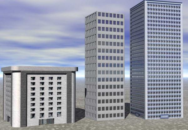

    I know it can be frustrating to get some buildings at times to work in Bryce. I don't know exactly what you are looking for, but over the years I have posted a few Bryce specific OBP format buildings in my portfolio at ShareCG in case there is anything there that can help.
    http://www.sharecg.com/pf/full_uploads.php?pf_user_name=goshtac
    Bruce
    Just an example of some building models below I have uploaded as freebies.

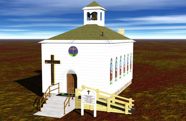

    I think you started something - ( I guess one more Iron in the Fire won't matter ) ;-) You got me thinking when I saw the church model you had rendered and decided it was time for a new building model for a Bryce Freebie.
    This is just a WIP at this time, but you gave me some inspiration to play around with a modern church design. Still need to make a bell, lay a foundation, do some steps, etc. But wanted to show you this and get your input on it. Once done I will save it as a Bryce OBP preset so members of the Bryce community can play with it if they so desire. ( Model is external only - No insides)

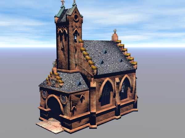

    I showed this church to others on another site, and it occurred to me it would be good if they saw it before I put it back together. The first image is how this .3ds church imported into Bryce. The second image is another different material on the church. While this material obscures some of the church features, I think it does look rather nice. Especially with a different roof material.
    1080 x 810 - 917K

  • GussNemoGussNemo Posts: 1,855
    edited February 2014
    @Dave: That's an idea I'd never have come up with, what with my limited experience. You've made me curious with that idea, so much so I'm going to give it a try. If this works it'll be quicker than trying to reassemble without instructions.
    EDIt: Nice idea, Dave, but no go. Each of the pieces I looked at has its own Origin Point. I even tried zeroing a few pieces to the main part of the church but ended up repositioning those pieces. I have a couple of other .3ds formatted buildings which also import out of skew, I'll give your idea a try with them.

  • GoshtacGoshtac Posts: 130
    Hi Folks;
    Just a little update on the church model design - Still a WIP as I notice a few things I want to address yet like the sides of the buildings which are just a bit too white. In certain lighting it just washes out and even the lines of the siding just disappear. Also I may have to redo the handicap ramp from scratch as it is one of the few Booleans I made and I am not overly fond of the texture of the wood. Shows up a bit too much even at a distance.
    Luckily most of this model is just grouped so far so it can be modified yet as needed -- Thought when I set it up as an OBP freebie I may offer it in two versions - a static Boolean and a grouped model so end users can modify what they want. I still have a few things I want to add or change such as taking the static front door and making it into an opening door showing a foyer just inside to add to usefulness to end users. Thought for the scene sample I created with it, the doors just opening with wedding couple just coming out would have been nice???
    Any comments, suggestions, harsh words, always appreciated. First is just the stand alone model WIP and in the second image I call Waiting on the Bride and Groom I created a little scene of a photographer waiting outside for wedding to end. ( Having done wedding photos myself back in the day, I would not be outside like this waiting, but needed to add this to give more to the scene )
    Hope all are having a great weekend.
