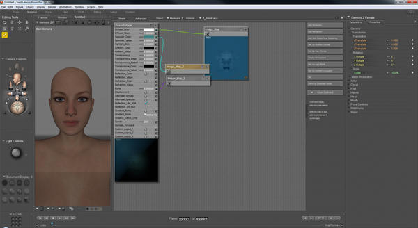

    That's what I did and it gets applied to the legacy material zones in Poser (the ones with the numbers).
    Unless it's a bug. Take Sirena V5 for example. She's on V5's UVs, but yet look what happens in Poser using PoserCFs.
    The mats get applied to the legacy material zones and don't show up on G2F.
    1920 x 1050 - 1011K
  • Male-M3diaMale-M3dia Posts: 3,584
    May not be a bug as generally every material file needs to be in DSON format to apply to G2, even in DS. In DS you can manipulate the legacy material zones, but generally G2 only saves out the new material zones. You may need to fill out a ticket to see if it's an issue. Also I believe the Genesis 2 Female UV is the default, not V5. V5 is for compatibility with the last generation.

    Well, I used a UVSetter by Slosh to set G2F to a V5 UV and tried reapplying Sirena.. still doesn't work. Again, Sirena was applied to the legacy surface zones and never showed up on G2F.
    Note that I am applying SirenaV5 using the PoserCFs that came with it, and I do have the main DS version installed as well.
    /edit
    Ok, there is seriously something screwed up with my G2F in Poser. I can't even apply the default Bree texture. Posted in Nuts & Bolts.
