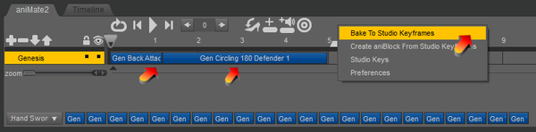

Then if your Animate timeline (inactive) hidden, ds only show animation which keyed on ds timeline.
you can change which timeline you use. I suspect,,if you hide(inactive) animate timeline without intention.
if your animate timeline is same as my pic,
you need to click the eye icon , then turn to visible (active) animate timeline.
(I often feel it seems opositte which I expect,, the eye icon indicate daz timeline visiblitiy I think)
Then,,if you have not gotten full-featured aniMate2 product version, you can not save the aniblock,I think.
about this case,, you may need to bake aniblock to daz timeline then save as scene,
or save as poze preset. but it can apply on daz timeline only. not to be used as aniblock,I think. ^^;
