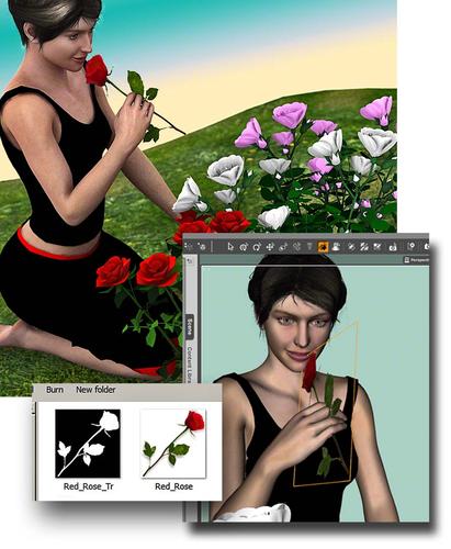

    What you see here is a picture of my viewport, so it's not a render.
    I've put up a plane (rotate 90 on X etc..)
    You see the orange line, that is the outline of that plane.
    In the surfaces tab you put a picture in the diffuse channel and the alpha plane (black&white;) in the opacity channel.
    In the final render black will be transparent.
    Of course it will mean some work in Photoshop or what ever you use.
    Nowadays I render to png and put in the background later.
    894 x 1200 - 132K

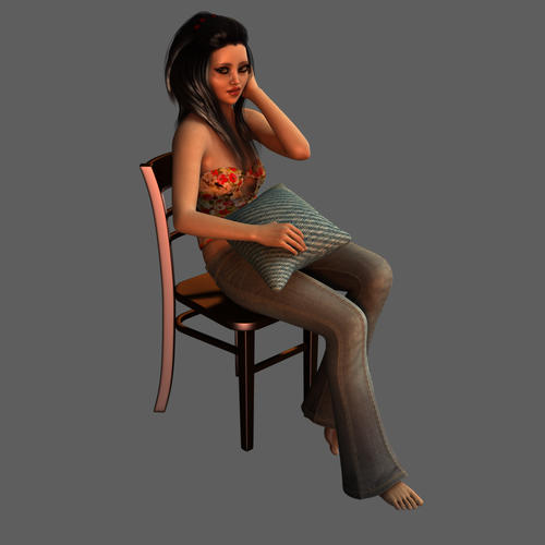

    I have Photoshop CS5 Extended and haven't really played with the 3d features much. Out of curiosity, I used 3d layers and repousse to create a simple pillow object. From my experiments, you want to export wavefront obj format. Not sure which option is the best for import. I found it easier to work with my pillow when I converted it from a prop to a figure but that might just be my imagination. I tried to export the materials but couldn't figure out how to get daz to pick them them. I ended up plugging a seamless pattern into the diffuse and bump map via daz surface editor tab.
    There's a youtube video out there creating floor lamps...haven't tried that one yet but might. Just wanted to create something easy with the pen tool.
    Anyway, I get why you want your figures to interact with 3d objects. Still for your backgrounds you can easily do those in a 2d space instead of plugging your image into a plane. It'll be easier to add shadows...then again I haven't figured out shadow catchers so someone might strongly object to that statement. (There are a couple of really nice wilderness type sets in the store that are backgrounds with shadow catchers but I haven't really explored what makes them tick.)
    Anyway, here's an example of a Photoshop created object. (It's my first attempt at this so I went for extremely simple.)
    1000 x 1000 - 161K
    Post edited by Pixel8ted on

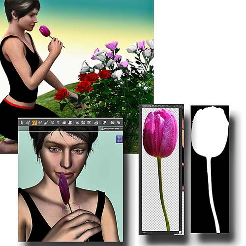

  • TjebTjeb Posts: 507
    In the case of the rose it was very simple. I searched Google Images (not just Google) for rose+png.
    (in this example tulip+png)
    I open the image in Photoshop, use magic wand (not sure in English photoshop version) fill the background with black,
    reverse the selection, fill the rose with white and save it as .png. (I add something like TR in the filename)
    It's not always that easy. When you cannot find a suitable png you have to wipe out the unwanted part of the image.
    800 x 800 - 127K

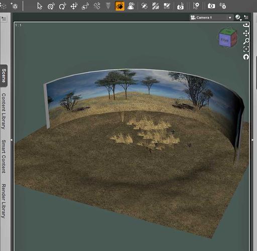

    @oldblock:
    is the Multiplane Cyclorama not a part of the content that comes with a new installation of DAZ anymore?
    860 x 840 - 96K
  • oldblockoldblock Posts: 99
    Wow just what I want. To answer your question; No, apparently not or if it does I can't find it. I didn't know MC existed so I'm once more indebted to you. This led me to check for the latest version of DAZ and also search for A Multiplane Cyclorama and I'm looking at DS4.6.2 and DAZ Pro. Multiplane Cyclorama has got to be lurking in one of these so I'll download them. No such luck. Download isn't working - nothing comes easy with DAZ - but I'm a hardened user now and obsolete tutorials and help files that haven't been written yet come as no surprise but a marketing system that won't let you buy anything has to be a first. I try again in a day or two, meanwhile now you've wised me up I can plan ahead and get back to this when DAZ have got their act together.
    Thanks again.

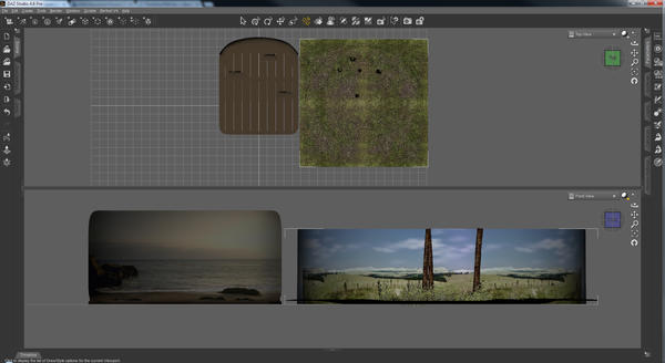

    Yes it is. The beach was added back into the Genesis 2 Essentials set. http://www.daz3d.com/forums/discussion/33933/
    edited February 2014
    mjc1016 said:
    No, the Cyclorama isn't included content, any longer...
    Although the beach isn't as big as the cyclorama.
    Beach on the left. Multiplane Cyclo Millenium Environment on the right.
    *edit*
    Sorry, this thing is the Millenium Environment, not Multiplane Cyclorama. I'll leave this here though as a comparison with that as well.
    @oldblock:
    Looks like you did the same thing I did. lol
    1920 x 1050 - 754K
    Post edited by Lissa_xyz on
