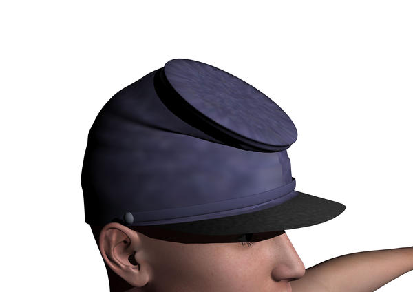

    I am pretty confused as to how to do multiple UV's in DAZ 4.6. I don't use ZBrush, GoZ, whatever. I am just using Hexagon and DAZ 4.6 in create uniform items. I cannot get the button textures nor the chinstrap textures to load onto my shell jacket. I would greatly appreciate someone walking me through how to resolve this problem. Thank you.

  • wdsmith1959wdsmith1959 Posts: 60
    As you can see, the chin strap on the forage cap should be black leather and the buttons should be brass. The buttons on the jacket should also be brass. One other problem I'm having is in replicating the wool texture of the clothing.

    Yes, buff is for staff, yellow for cavalry, red for artillery, and blue for infantry. I was using this particular figure to test my sleeve rank, etc. I'm just having difficulty getting the chin strap on the forage hat, and the buttons to have the correct texture maps. It does get a bit complicated, but at least I am making some progress :-) , compared to where I was just a week ago . Thank you for the homespun texture. I'll try to use that and change the color. Some of the Confederates later in the war used what was called "jean cloth" which was homespun combining cotton and wool.

    One of the things to try...and is often easier to do...use a seamless tiling texture instead of trying to map a texture to the pieces. It's a lot easier to keep the 'scale' of the weave that way. In DS the tiling will affect the diffuse, opacity, specular, bump and displacement maps. It doesn't tile normal maps (and I don't think it tiles reflection maps, either).
    The only problem with it, is that overlays/patterned appliqués/embroidered 'doo-dads' that are applied to the texture map will also tile. There are two ways around that...use a 'geoshell' to hold the add-on (DS 4+) or create even more material zones (works best for things like stripes).
    What I am running into is that the weave of the fabric texture isn't even showing up on my figures. It is much too pixelated and I do not know how to fix this. I also don't fully understand the "checkerboard" thing.
