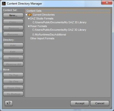

    Can you please post a screenshot of the expanded listing of Edit > Preferences > Content Library > Content Directory Manager, showing the paths that you have listed for BOTH DAZ Studio Formats and Poser Formats.
    If you used DIM to install, it installs content by default into C:\Users\Public\Documents\My DAZ 3D Library and that path needs to be listed in BOTH Poser and DS formats.

    First of all, where did you install the content to, and did you use the DAZ Install Manager?
    476 x 463 - 36K

    "If you used DIM to install, it installs content by default into C:\Users\Public\Documents\My DAZ 3D Library and that path needs to be listed in BOTH Poser and DS formats."
    My Poser is on an entirely different drive in dozens of runtimes. I have it setup accordingly in DIM.

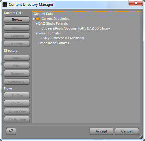

    This is what your paths SHOULD look like DS should ALWAYS be pointed to its Content as BOTH DAZ Studio Format and Poser Format. The Runtime folder IS used and only read if listed as a POSER format folder as well...
    476 x 463 - 33K
    Presently that's what I have. This weird issue is with a Poser only item.
