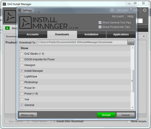

    This may help identify what I am asking. Do I have these settings correct for downloading into Poser 10 in the install manager?
    I need to make sure that the install manager is set up correctly. I am a real novice when it comes to using this. It seemed to me that there was another place in the installer where you could choose to install content into Poser 9 higher or Poser 9 and lower. At least something like this. I am just trying to get the installer to put content into Poser 10. It works just fine for installing Daz Content.
    I am not used to this new installer and am trying to make sure it is set up correctly to install poser content into poser. I understand that there are different content folder but get lost on how they work and how they are set up.
    This is the first time I tried posting picture hope they go through.
    583 x 543 - 218K

    All you Need to Do is set the DIM prefs' so it will install content for Poser as well as DAZ Studio if your using one folder. That is found here...
    To Set the DIM to ONLY install Poser Content to the Poser content folder takes more work. All I do is set Poser to SEE my DAZ Studio Runtime folder in the My Library folder. Works a charm.
    685 x 588 - 73K

    In the example Jaderail's picture shows the DIM is set to download to C:/Users/Public/Documents/DAZ 3D/InstallManager/Downloads
    fixmypcmike is this the path I add to my content folder in Poser?
  • fixmypcmikefixmypcmike Posts: 19,740
    No, that's where DIM is downloading the zips to. You need to point Poser to the place you're INSTALLING content, such as "My DAZ 3D Library".
