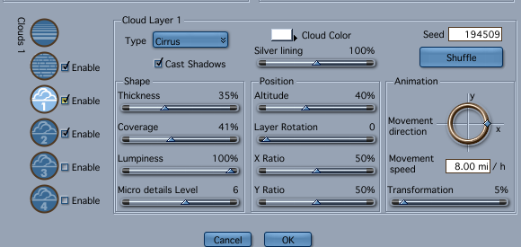

I have created a scene in C8.5 and am using the "Realistic Sky" tool. Everything works as expected, except I cannot get the clouds to move in the animation.
I have played with some of the values, but the most I can get is some minuscule changes in cloud shape over time. The changes are barely noticeable around the edges of the clouds, and could be due to the changing light in the scene.
Either way, all clouds stay in place and do not move, which is what I am trying to do.
Any suggestions, settings or working links?

  • jrm21jrm21 Posts: 140
    I had tried what you are suggesting but the settings didn't stick. In the RSE, I entered one set of values at the start of the animation and then entered different values at the end. While some values stuck (like the sun position) at both keyframes, the cloud settings didn't. In other words, If I set it to "1" at frame 1 and then "99" at frame 100, it would show "100" when I went back to frame #1.
    I went back and tried again. The values seem to be changing as they should. Layer rotation does have an effect, but it does look funky (appears as if the cloud layer is rotating rather than the clouds moving).
    In the RSE under "animation" for the cloud layer, movement speed is bumped up to the maximum 99mph. That also seemed to do nothing.
    Then I found it... In the "Atmosphere" tab - Clouds Animation. I originally set the value to the 12 second length of the animation. Apparently, that value needs to be outrageously high to get visible cloud movement. I set it to 5000 seconds and then 10,000 seconds and the clouds really started to move across the sky.
    Not very intuitive, especially since the RSE has a movement speed setting. That setting seems to have a relative affect on the clouds, but the number of seconds in the "Clouds Animation" setting is what really makes things happen. Still have to play with the setting to get things moving the way I want, but at least they are moving now.
    Thanks for the help.
    I was going to ask if you had selected the right cloud layer, but I see you have things kind of sorted out.
    580 x 275 - 57K
