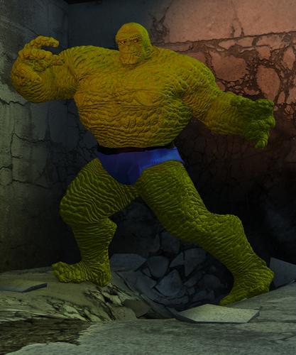

  • RKane_1RKane_1 Posts: 3,039
    edited January 2014
    Well, crap...ok. *pout*
    720 x 864 - 452K
    Post edited by RKane_1 on

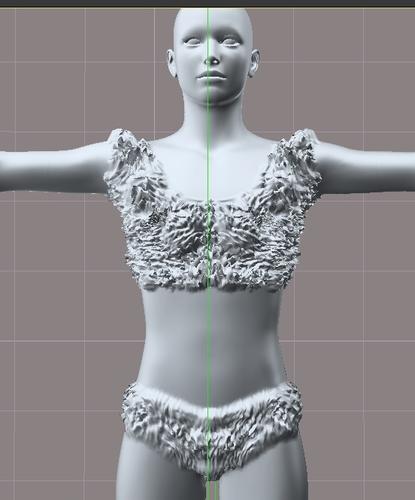

  • WendyLuvsCatzWendyLuvsCatz Posts: 41,839
    I was playing with displacement brush on a subdivided mesh in carrara and it occurred to me
    this could be used on clothes too
    (or to make inbuilt clothes on the mesh like I did)
    552 x 665 - 74K
