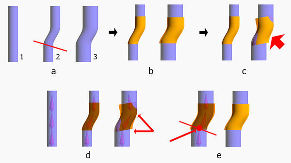

Modeling a cloth i found a problem when i try to make it conform to all basic shapes for genesis...
First, i try to explain my problem by schema (because of my englih), and don't show exactly what it is, what cloth or what part of body simply because i want to understand where is a problem, not resolving it by just an easy cheat for such cloth or other.
fig.a
1. base model (blue)
2. model posed (up the red line, the figure will be static)
3. model with FBM applied (in my case FBMheavy)
fig.b
1. cloth modeled on base model (yellow)
2. cloth modeled on "FBMmodel" (yellow)
without being fitted, the morph works and it's in position, and all seems correct.
fig.c
1. cloth fit to the model... ok
2. cloth fit to the model + FBMmodel applied... PROBLEM!
fig.d
Looking bones, the different alignement is causing the problem... at least is that i think...
fig.e
i resolve part of the problem adding an ERC to my FBM cloth... it works until i rotate the joint at the base.
i was looking the tutorials again and again, and don't find how to resolve this and i don't understand where is exactly the problem.
sorry for my english, i hope you can understand my problem. :/

    i forget to tell that i've already use the 'transer utility', works well for a majority of basic fbm genesis (originals). But for some reasons, and that is my problem, for some fbm like FBMHeavy that don't work. It's surely due of a scaling or translation in that FBM like you said, then i think about same problem with other figure like victoria5... :/
    I managed to make my morph (FBMHeavy) works Adding Some ERC after using a 'transfer rigging'. the result was like fig.e, that's what i want, the cloth Correctly Posed and morph but for some reason, and just in only one joint (one that is at the base of the part that moves and that remaining static fig.e). If i plan to not move my figure, it's ok. but i would at least can move my figure at this point fig.e
    Is there a possibilty adding an ERC with the FBMheavy created for my cloth and keep that's bones positions? i mean, after fit, if i select genesis, change my shape to Heavy, the bones keep the position of the ERC added... and not changed by the FBMHeavy of the genesis that apparently leads all after the cloth fitted.
    hope you can understand what i mean... i think it's not very clear...
    thanks.

    It seems more simple problem,, not about FBMheavy used rigs rotation (but not change poze)
    even though the FBM do not rotate rig, when you make morph for pozed figure, it should happen.
    The porlbem of OP is, fig b.
    he said cloth modeled on FBMheavy. but no.
    he modeld for FBMheavy + pozed shape. (rotate rigs for pozing)
    the rotaiton when pozing rig, and the rotation when set joint for zero pose
    to fit morphed mesh shape has diffeernt meaning.
    if OP try to make morph shape obj, which fit to current pozing shape,
    OP can only apply delta from current pozing and morphed shape.
    and usually plan to set ERC for rotattion of the rig for pozing.
    so that, when rotate rig, the delta morph work well,
    and may plan to set ERC for FBMheavy too.
    to work it when apply FBMheavy only.
    Then actually he did so. then it work for the pozing.
    But it only work well for the pozing (or the node rotation of the axis, he pozed)
    but ERC keep step value , so that sometimes it is not so smooth transition.
    you may need many point for one rotation. or you may need many anotehr ERC morph for each rotation.
    (so that, we do not plan it usually, I sometimes try them but it can never perfect fit clothing for all pozing)
    OP seems try to use the obj made for pozed shape with FBMheavy,
    to overwrite FBMheavy.
    but it is delta morph from zero poze sero shape. so that it can not work as he expected.
