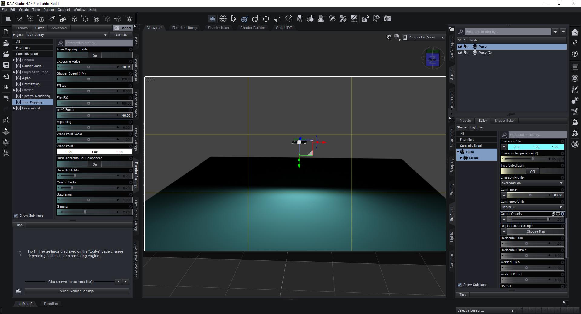

    Like you, I typically use planes with 1 division.  As noted in the video, he uses spheres, but you can still use planes with ies profiles.  In the example below I have a plane, with an overhead ies profile, single sided light to get the down light effect.  Turned up the tone mapping cm^2 factor to increase the light.  With the wide variety of ies profiles, you can get just about any shape light out of a plane, so you don't need to use a sphere.
