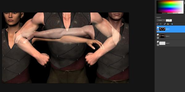

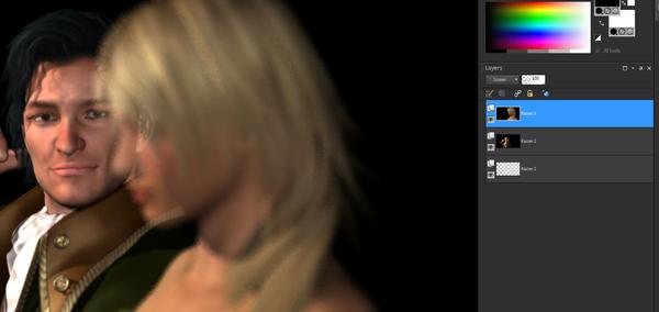

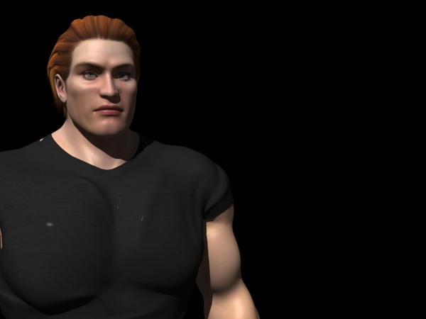

    Thank you all. Thought a picture might help.
    This is what is happening to my composite.
    I start with a new transparent layer and set it's background color to black. Let's call that the base PSP file.
    I open a rendered file (BMP), select All and copy paste into my base PSP file. It creates a new layer and I set that layer to Screen.
    I open a second rendered file (BMP) and do the same process. I set that layer also to screen.
    See how the second render is transparent where it should be actually "hiding" what is behind it?
    Again...this process works fine in GIMP and I've seen someone do it in PhotoShop.
    1530 x 766 - 87K
    1406 x 665 - 69K
    edited January 2014
    That's how screen works, it blends. Does PSP have layer masks?
    /edit
    You also have 2 layers set to screen with a transparent background layer. Set that background layer to black and see what happens.
    Post edited by Lissa_xyz on

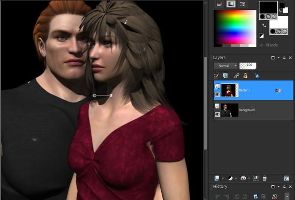

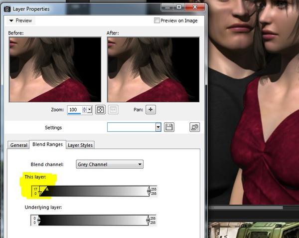

    Basic renders used for the exercise..
    Used PSP X6
    It's not good.. needs fiddling...
    I would rather save out as PNG files.. much easier and faster..

    Good tips Stezza. I don't think I've ever used the layer properties like that.
    McKinnon-can you save your renders as PNGs instead of BMP? Then you would get the figure on transparent background and when you paste them as new layer in PSP the top layer will hide what is underneath it. (Apologies if you stated that you couldn't render out PNGs and I missed it.)
  • McKinnanMcKinnan Posts: 0
    Wow!!! Between the spread of you generous artists, I've learned how to do this!!! Thank you especially to Arkathan for Ctrl+L, Stezza for showing it IS possible and Coon Ra for explaining that I should be using TIF and not BMP/JPEG (yes!! I'm off to learn about alpha channels and composing layers... didn't even know that was the terminology!!).

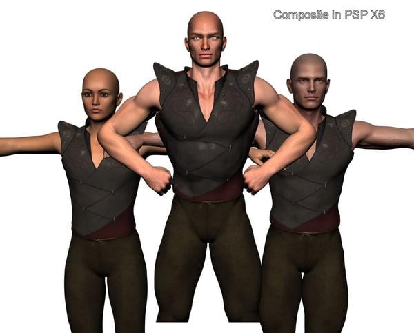

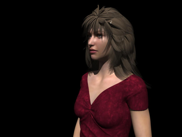

    Uploaded images of the render in DAZ and the composed layers in PSP X6. I'm not worried about the background at this point. Just wanted to get something up for you guys to see. THANK YOU again!
