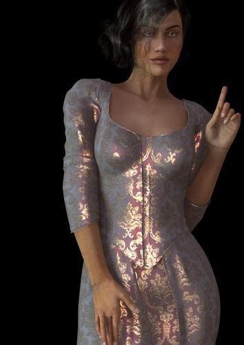

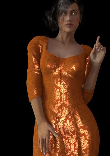

    I really like Shader Mixer, do I understand it fully? No...it frequently causes my brain to melt down. But it's worth perservering with as you can get effects that you might otherwise find difficult...I've been playing with satin's and here are some renders.
    The image with the light effect on the floor is also a shadermixer shader on the floor...

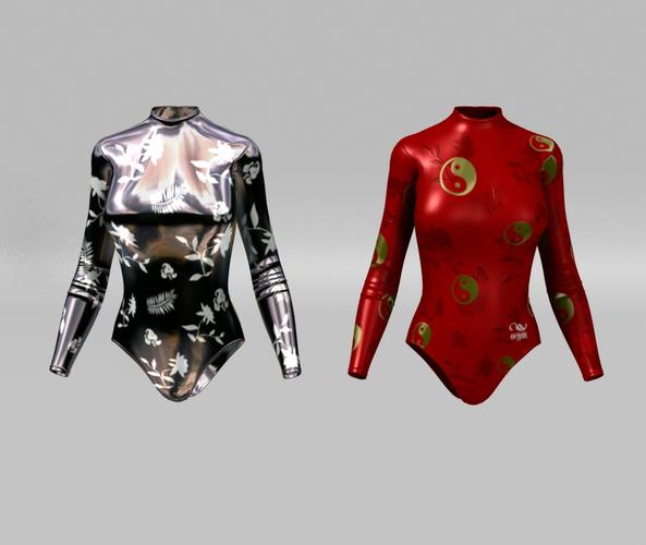

    Poser material in DS on the left, Shader Mixer equivalent on the right, this is what the Shader Mixer is all about for me. The ability to recreate Poser materials so that my content looks how it's meant to, the ability to get creative, and not to be restricted to using hardcoded one trick pony shaders.
