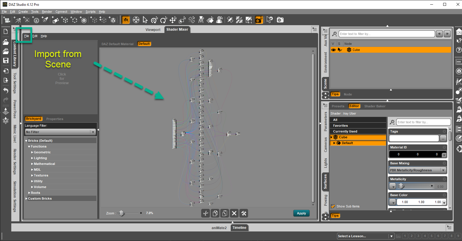

Okay ... the forums are for questions and when it comes to making Iray Shaders, yes I have a few ;-)
Was told to use the MDL bricks, so like okay.
If one "imports from scene" from a basic new cube, one sees quite a lot of wires! I understand the concept is to plug in each brick to another and somehow one is also going to connect to the object for display.
So pacing this back big time, since none of the "previews" seem to render any results whatsoever, hopefully somebody or bodies have time to walk us through the process for to start making, let's say a very basic beginner Iray Shader.
The first 3 on the list are for what please?

    First off, stay away from "Import from Scene", most of the shaders we use were not made in the SM, and simply wont Import, some however are tied to an algorithm that tries to recreate the shader out of SM bricks, and the one tied to the default surface shader hasn't worked right since before the prelaunch betas of DS3, so no telling what your going to get trying to import a far more complicated shader like Iray Uber.
    I'm quite adept at using the SM with RSL, but the MDL setup scares me, it's complicated as hell, but to get you started, https://www.daz3d.com/forums/discussion/242936/an-iray-shader-mixer-cookbook/p1 , it's a thread that shows some of the basics.

    If you want a basic no frills shader to mess about with then make sure the Iray render engine is selected, open the SM, go File > New Shader, select Material, give it a name if you want to, then click Accept.
    It's a basic Iray shader kind of similar to the default surface shader for 3DL(missing a few settings though), just watch out though, many of the bricks used in it have had their names changed from the ones in the Brickyard, so figuring out which is which is a bit of a pain.
