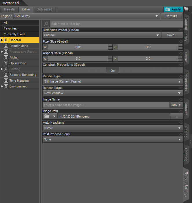

  • fastbike1fastbike1 Posts: 4,084
    edited October 2019
    Render Aspect Ratio is in Render Settings>General
    663 x 701 - 44K

  • FishtalesFishtales Posts: 6,238
    If the Environment tab is open and set to Backdrop there are two settings in the Flyout Menu, the three horizontal lines at top right, for 'Adjust aspect ratio to backdrop' and 'Adjust dimensions to backdrop'.
    Thanks, Richard and Fishtails, That is exactly the setting I was remembering seeing.
