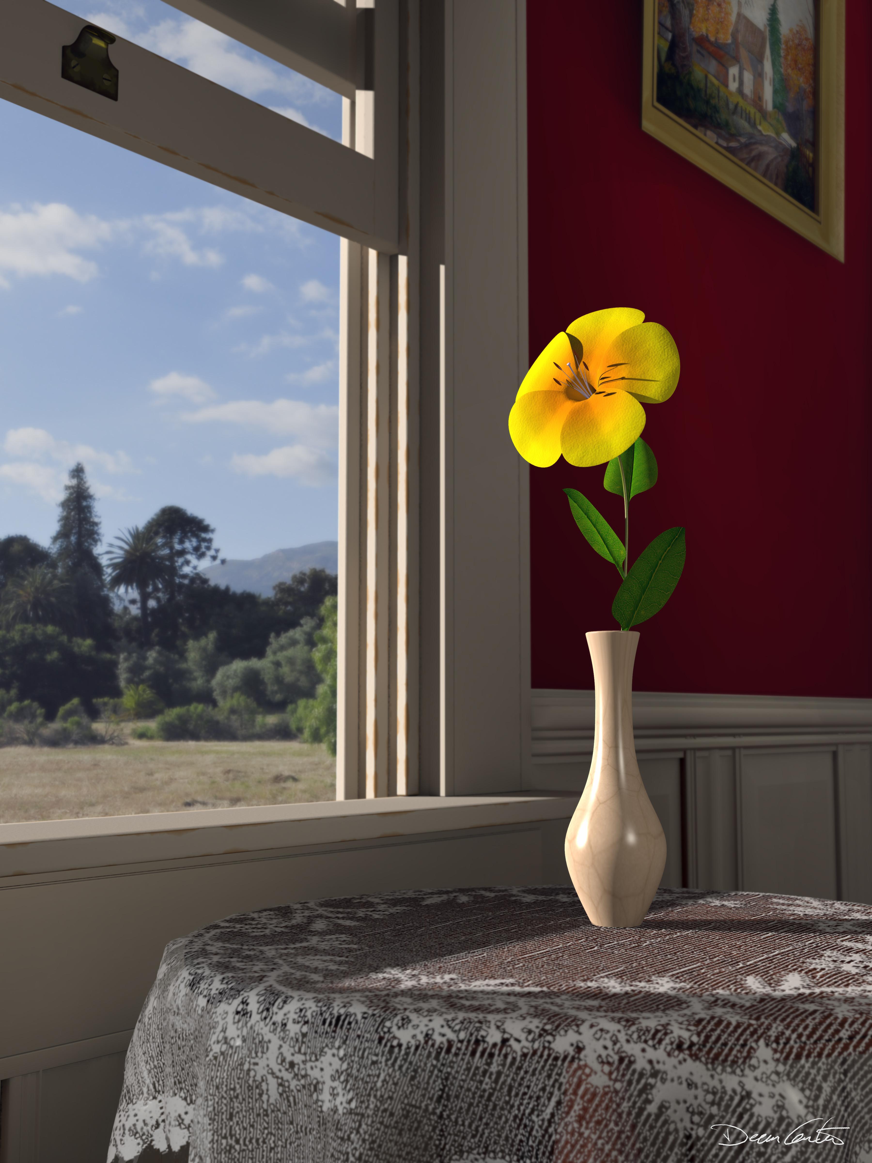

    When I needed a window for this scene, I first googled "double sash window" to get the general idea of how it should look, since I don't have any of this type of window in my home to use for reference. (Having the actual physical object that you want to model helps immensely.)
    Then I googled information on how to build them, and started modeling the various pieces that I would need to assemble into a window.
    I probably ended up with more geometry than necessary to represent a window, but I can open and close the upper and lower sections as needed, and it has enough detail for close-ups.
    I spent a lot of time doing this, so I won't say it was easy. It's mostly just a lot of rectangles though. The latches were a little tricky as I recall.
    This probably doesn't help you too much, but it describes the process I use to create objects.

    Very nice room de3an, love the texture work.
    +1

    Thanks guys!
    Here's the window model in Hexagon format if anyone wants to play with it. (You'll have to unzip the file first.)
