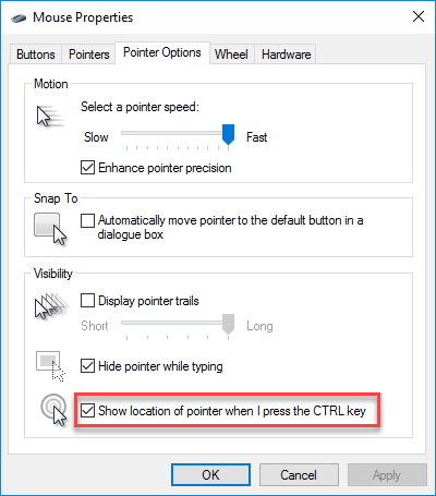

  • TaozTaoz Posts: 10,377
    edited October 2020
    If you check this box, pressing Ctrl will show where the mouse pointer is:
