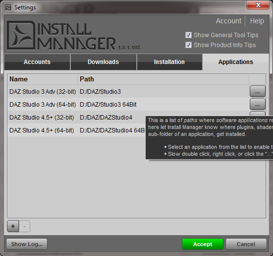

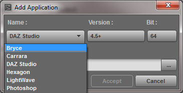

If you use DIM then you must indeed point it to the path where you have Bryce 7 installed.
A couple of screen shots. THese were done by someone who doesn't have bryce installed, but subsitute Bryce for the DS and point it to where your Bryce is installed
