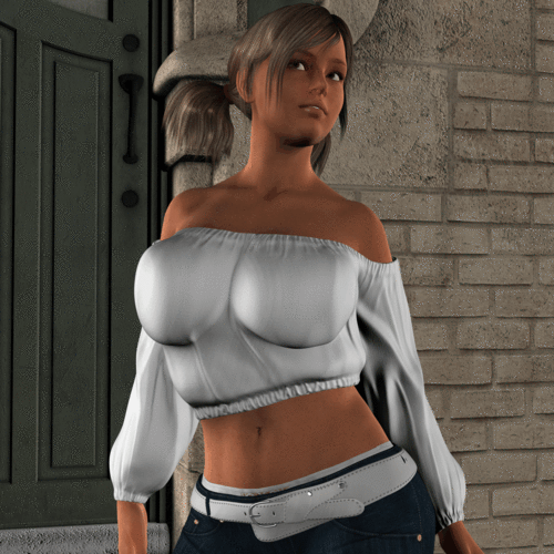

I try to render a simple character picture; 1 figure (close up), background wall, 1 light; at 4000x4000 with DAZ using Reality.

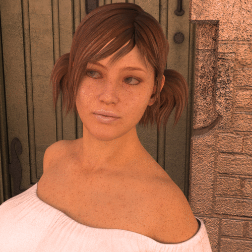

I render it first in 1000x1000 and it took only 20 minutes for a first result (picture 1) but render the same scene (only different camera angle) in 4000x4000 take now over 8 hours and not even nearly the same result (picture 2). (both Pictures are resized for posting it here)
I thought 4 times bigger takes 4 times longer (a picture 1000x1000 takes 20 minutes so a picture 4000x4000 takes 80 minutes) but it looks like this is not correct...
Can anyone tell me how the math works for the render time?
1000 x 1000 - 942K
1000 x 1000 - 882K

    First, 4000x4000 is 16 (!) times bigger, not 4. So it sounds about right regarding rendertime.
    Second, please check if you have same settings in the renders (apart from the size difference). (Don't know if the computer can go haywire if the render is to large for the RAM to handle).
    It is not 4 times bigger, I think that is your problem, it is 16 times bigger.
    There are 16 1000 x 1000 images in a 4000 x 4000 image. So 20 minutes x 16 = 320 mins = 5.33 hours.
    The extra time could be larger texture images, and different lighting too of course.

    Base math was my fault; I thought 4 times 1000 = 4000 so 4 times 1000x1000 = 4000x4000, but even than 8 hours with nearly no result is a very long time.
    Settings and the Image (no other texture, no other lighting) are the same (I only change the position of the camera).
    The computer is still working and Luxus is working, too. But after 8 hours not even the skin color is showing and the counter is only by Tot. 0.83 kS/p.
    That confuse me a bit.

    Okay, so first question because the story I'm getting seems to point to it... Are you using both Luxus AND Reality? The only way I can see that you would get such wildly different results would be that you're using 2 different interpreters for those two images.
    Reality opens up a window which will convert materials automatically to varying degrees. Those settings are not carried on if you decide to render in Luxus. Luxus uses its own set of materials and those need to be applied and tweaked to get the most out of your images. I believe your main issue with the 2nd image may be an exceptionally high specular value on surfaces, which not only causes too much reflection (thus too few light rays being removed from the scene and needlessly overcalculated) but also washes out the colours.
    Always remember that both Luxus and Reality will need their own set of light settings and surfaces and are not intercompatible without editing the files manually after export.

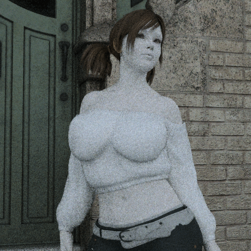

    Even a test with 4000x4000 in 3Delight only needs 2 hours (see below - only resized for posting) but 3Delight doesn't look as good as Reality or Luxus.
    1200 x 1200 - 1M
    Post edited by R25S on

    The 1st and the 2nd picture (and also the 3rd one) use the same light... but with different results... so I don't think that it has something to do with the light.
    The picture added (resized) original rendered with 4000X4000 in reality with a IBL takes about 20 hours.
    No; there are no errors in the Luxrender-Log.
    1000 x 1000 - 1M
