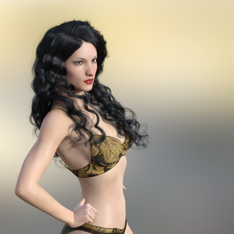

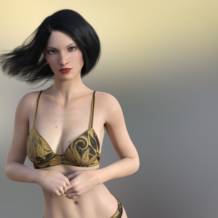

    I know some people see this problem, but it's something I've not experienced with 4.10, 4.11, 4.12.0.86 or 4.12.1.16 Beta. Here are two examples with OOT hairs. The second example uses the same hair and a similar pose as the example from @Richard John S.
    750 x 750 - 494K

  • FrinkkyFrinkky Posts: 388
    edited October 2019
    I never used to get this with my old GTX 970, but ever since I got a new computer which has a RTX 2060 card I have been getting these black blotches on the character's face when using hair by Outoftouch. Below is an example.
    I get this on a 970 and a 1070. It seems newer versions of iray in the later versions of Daz are less forgiving with transparencies intersecting or just being in very close proximity to another surface. As pointed out, all you can do is push the forehead out and/or use a push modifier if no adjustment morphs available.
    On a similar note, I've had to increase geometry shell offsets by an order of magnitude for exactly the same reason. In the past I'd use as small an offset as possible, now, I'm lucky if I can get away with 0.075.
