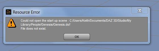

    But it seems to me, on start up, Daz is trying to READ the wrong path. I'm attaching the error message again.
    How do I change that?

    So I figured it out. I had to change the Poser formats installation path in Content Directory Manager as well as Daz Studio Formats. Then content appeared.
    In addition I had to browse for and change the installation path for Load File in Startup under Preferences (from Edit) to avoid the startup error message.
    Just fyi.

    Yes, both Poser Formats AND DAZ Studio Formats must have the same path to the content folder.
    The startup scene is trying to load from your My Library folder, AND it is trying to load Genesis.DSF which no longer exists, it is now Genesis.DUF (the new format).
    Glad you got it working, you should have no further problems.
