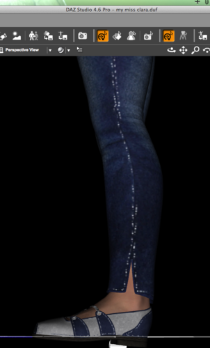

How to pull shoes to the ground level while keep feet stand straight?
Leo ChenLeo Chen Posts: 697
Is these any easy way to do this?
567 x 938 - 261K
    If you look under the parameters tab and click on the foot you can bend it by degrees which will allow you to easily correct any issues with heeled shoes. Often times heeled shoes for the newer figures will include a 'foot pose' which will do this automatically and adjusts to any pose your figure already has applied.

    Thank you,HeraldOfFire.
    It helps.
    I still need to level the foot (with shoes) to the ground,right?
    Is there any easy way to do this precisely?

    Select your figure in the scene and make sure the clothes are parented.
    Then use the green dial in the parameters tab to lower your figure.
    It helps.
    I think that would depend on the shoes, as most vendors include a preset/foot pose. If there is one included, be sure to have Vicky (or Genesis) selected and then apply the foot pose preset. That should place the shoes and feet solidly on the floor. I find this a huge help with high heeled shoes. With flat shoes as you have here, HearldOfFire's method will work if there's no foot pose preset.
    Thank you, Estroyer.
    I just hope there is any other way to "auto" level down the figure(with shoes) to the ground.

    Thank you,MissB.
    DS does have a command to AUTOMATICALLY move figure or object to the ground precisely.
    But how to AUTOMATICALLY move a figures with shoes to ground PRECISELY?

    Oh, see I don't have DS 4.6. I mostly use DS 3 Advanced, and have DS 4.0 Pro for Genesis 1, so I wasn't aware they had built in that command.
    I don't know if this would work, but if you can move a figure or object to the ground precisely, have you tried selecting the shoes and using that command?
    I can't imagine what it would do with the shoes fitting the figure, or whether the figure would even move with the shoes if you did it that way, but it might be worth a try.

    You Pose the Foot so it will be correct and then use the Parameters mini menu (the four lines) to do move to floor. That is not a proper pose for a foot with a heeled shoe on. You will often need to pose the foot and then do move to floor. It is just part of working with 3D figures. Everything is not automated for us.
