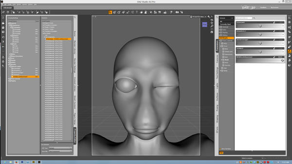

    here is a visual example of what i am trying to explain.
    as you can see the MCMs are in the heirachry and properly linked to the genesis morph they are there to modify but when i load a new figure and dial up the morph, the MCMs no longer work

    If you expand the options under the two morphs what are they set to save with - the MCM morph itself or the controller?
  • AVP_hattonslaydenAVP_hattonslayden Posts: 33
    hmm i don't know... i will go through my process and post it here, then people can see if there is a step that i missed
  • kitakoredazkitakoredaz Posts: 3,526
    if you store ERC formula in PHMs, it means you modify default genesis expression morph files.(or controller of them)
    so that, you may need to save ERC link with your original MCMs (sub components)
    then, after set ERC (which you have done already), and save type correctly, (save with Controller file, or sub components file)
    At curernt, only MCM instances have ERC links.
    To load them correctly, you need to overwrite modified files (add ERC links) as morph assets again.

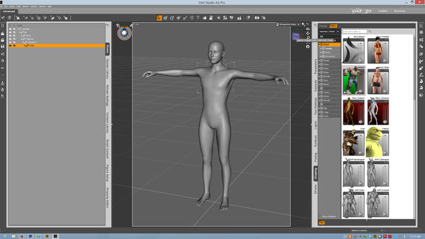

    step 1: 1st and second image: in a new scene i dial up my custom morph. the ERC is already been tweaked so it modifies the bones and i can export this to another computer.

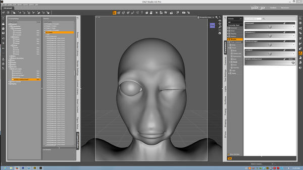

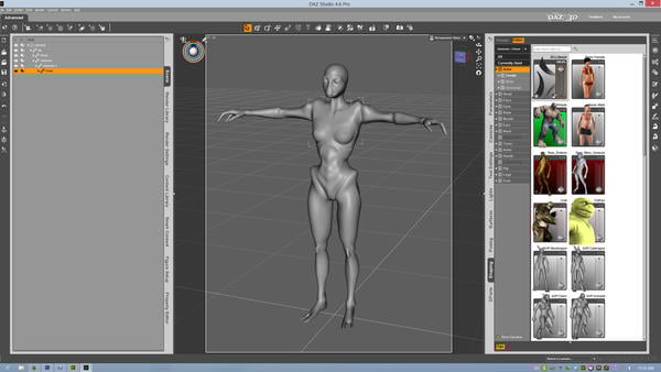

    step 2: 3rd and 4th image: i open up the properties editor (which seems to be missing in later versions of Daz 4.6) and parameters and dial up the 'left eye closed.
    step 3: import the corrective morph with morphloader pro and make sure revers deformations is on 'yes'

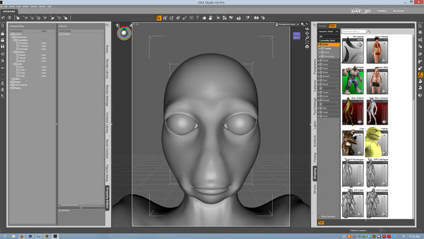

    step 4: dial up the morph and open up the hierarchy to start linking
    step 5: drag and drop the MCM into the ERC full body morph sub components and change it to 'multiply'
    step 6: drag the same mcm into the correct PHME file
    1500 x 842 - 381K
    1500 x 842 - 376K
