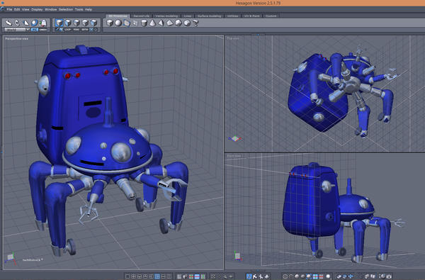

Please pardon my ignorance being very new to figure rigging but I see to be having trouble within the first couple of steps. I've built a figure in Hexagon and am attempting to rig it for posing in DS4. I had read a very good and succinct explanation by Richard H. detailing the matter but I'm not getting very far. I can import my geometry into Figure Setup tools, I can set up my bone heirarchy and get them properly oriented so they are set to twist, bend and move correctly but when I create the actual figure, only the 1st bone in the figure actually moves. I can see the bone outline moving correctly for the rest but the figure is not conforming to it. I tried checking out a youtube tute which seems to suggest a weld function not in my newer version. Any ideas?

    Well, I was being brief in my description... actually I'm just trying to get the damned 2nd bone in the heirarchy to bend. Being overzealous, I initially attempted to rig my entire figure with over a hundred parts (though not all moving), never having done this before and actually went thru and set everything into a proper heirarchy with distinct individual names... not so easy because it's not a humanoid figure... and quickly realized I was in well over my head. I've included a picture. It's called a tachikoma. It's from the anime scifi series Ghost in the Shell, basically it's a small robo-tank based on a jumping spider. There is no hip however there is a central hub on the bottom but I digress because I'm just trying to grasp the basics here so I separated a leg and attempted rigging it however the rigged leg is only following the first bone (called upper leg).

    If your OBJ is grouped then you can try switching to the Weight Map brush Tool, right-clicking in the viewport and selecting Fille Weight by Selection Set(s). The problem is that at the moment the weight maps for your bones are all empty, so the bones have no effect - you need to assign maps to the rotation you want, then adjust the maps as needed; the command above is a quick way of getting that done approximately, as a basis for further refinement.
