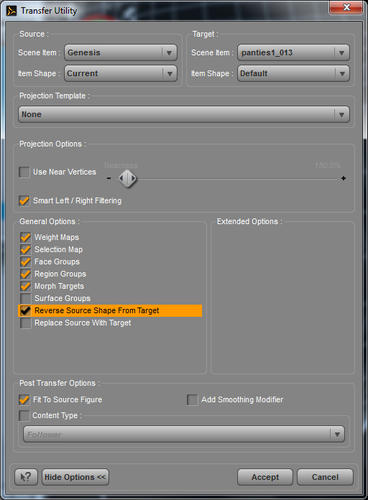

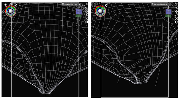

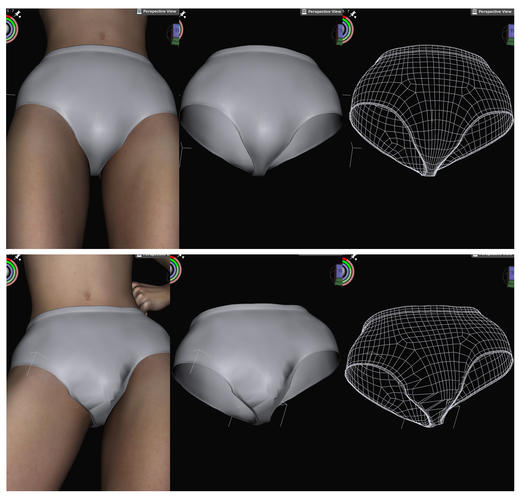

Granny Panty Problem.
This is my first attempt at creating a model, so pls be patient.
Steps:
- To create the mesh, I brought the Basic Female over in zero pose.
- I created the mesh from scratch in Hex and brought it over to DS via OBJ.
- Used the transfer utility to fit (see screen shot).
- It looks just fine … until I pose: then the mesh distorts; it looks like it pulls a very limited number of vertices rather than spreading the change of a number. (see screen shot: top row: un-posed)
What steps am I missing?
Thanks

  • WendyLuvsCatzWendyLuvsCatz Posts: 41,585
    on your third image
    under projection groups above Smart left/right filtering tick Use Near Vertices and move slider, more takes longer and could crash studio but is more accurate, have to judge it a bit
  • rol3drol3d Posts: 40
    on your third image
    Interesting: If I wind up the slider enough to reduce the distortion, the rest of the mesh no longer fits.

  • FistyFisty Posts: 3,416
    edited January 2014
    Bend out just one leg (or whatever direction of that thigh bend that's having the most issues), take note of the color of that slider.. look up and find the x y or x translation that's the same color, that's the easy way to keep track. Select the same bone (left or right thigh in this case) in the panties and change your tool to the weight mapping brush. Open the Tool tab if it's not, I dock mine with my content library. Find the applicable rotation x y or z that you figured out before and click on it to select it. Up at top of the tool tab you'll see 3 or 4 (I think it's 4, don't have it open at the moment) little icons that change which kind of brush it is, you want the 2nd from the left, the smooth brush. The size is probably fine but you may need to change the strength. Left click and drag over the areas that are not playing nice to smooth out the transition from bent to not bent.. best way I can explain it, you will see what it's doing in real time so it'll make a lot more sense doing it than reading about it. Don't do too much or you might get issues with other areas or the same bending in the negative direction. A dab'l do ya. You can also check the bulge mapping, sometimes that needs a little smoothing, it's harder to tell which one is effecting which way though on those... but you'll be able to see if it's jaggy on the red/blue coloring. If it's jaggy then smooth it a bit, if it's not then it's probably fine.
    Apparently the technical term for your rigging problem is "crunchy crotch", around from the 3rd gen era.. though it manifests itself slightly differently with Genesis than the old style rigging it's the same basic problem.
    Post edited by Fisty on
    Oh, once you've smoothed out the biggest problems you should turn on the smoothing modifier, that's what it's made for. You likely won't get it 100% perfect, or even 95%, it's really hard especially in that area and with legless things like that.
    Scene tab, select panties, upper corner pull down menu, edit->geometry->apply smoothing modifier. Try 3 or 4 and collision of 1 or 2 to Genesis. Higher than 4 might mess up your edging. Also try both base shape matching and generic,often times one will look better than the other and you never know which ahead of time.
    Well. I didn't quite understand the first part, So, I simply tried what you said in your second message (' ....Scene tab, select panties, upper corner pull down menu, edit->geometry->apply smoothing modifier.. ) and it worked. Thanks so much!
