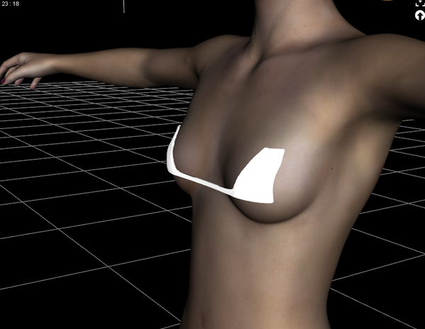

I modeled a simple garment (bikini top type of thing) for the genesis figure with the basic female morph slider set to 0. I modeled the garment around this shape in Blender and am importing it into Daz Studio and running the transfer utility. When imported, it appears exactly at the location, size, and scale to fit the genesis female figure.

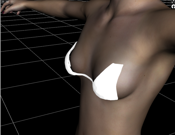

However, when I run it through the transfer utility tool, it seems as though it is trying to reapply the female morph, making the cups and front strap bend and misalign. There are a number of options that I have fiddled around with (item shape dropdown, Morph Targets checkbox) but so far as I can tell none of my selections make any difference.
What combination of settings can I use to prevent autofit from trying to apply the female morph? I've spent the half hour fiddling around with this and the wiki page isn't terribly detailed.

  • Richard HaseltineRichard Haseltine Posts: 111,992
