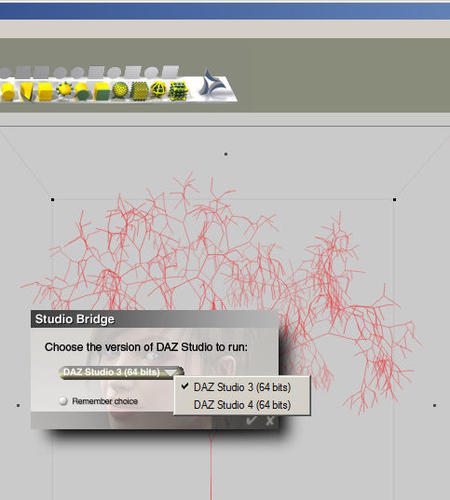

  • HoroHoro Posts: 11,772
    edited April 2014
    @leo - the bridges come with Bryce and Studio. There is nothing additional. Select an object in your scene and click on the DAZ thumbnail on the Create shelf. If you have more than one Studio installed (as I have), you will get a choice which one you want to start. If there's only one, Studio starts directly.
    I never had any issues though I still have Studio 2.3 for Bryce 5.5, 3 for Bryce 6.1/6.3 and 4.7 for Bryce 7.1. Issues I experience are due to the bridges that are not really fully and flawlessly implemented.
