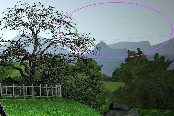

    Thanks Jimmy so if I create a camera can I then save a perspective view??? cause that's what I wanted.....guess you figured that...LOL...ok while you are there do you have any idea what is causing the blue lines in the render that I have circled??? I have used one spot light and one distant light only...

    Two things worth trying are to either convert the skydome you're using into SubD or lower the shading rate. One of those two should fix your issue. I've had the same problem with a couple of skydomes I use, and converting it to a subD object works every time.

    Are you using a SkyDome in your render? You may need to adjust the Shading Rate. It is set by default at 1.0, but it may need lowered a bit to 0.2, that may help.

    Ok thanks all I will try that.....oh to answer yes its a sky dome that comes with the Windmill set...Thank you Trish
