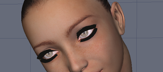

When exporting from DAZ to other applications, the eyelashes looks like they are a solid half moon.
(see attachment)
When googling on this it appears that it can be fixed in different ways in the RECEIVING application by changing the settings for opacity. But this change is always different for different applications and it is not very straightforward (for a newbie like me anyway).
As I am a newbie and are testing different applications for different purposes, trying to find a workflow that suits what I am trying to achieve – I would like to find out how to fix the eyelashes in DAZ3d BEFORE doing the export. By that I wouldn’t have to learn how to fix the issue in the RECEIVING application(s)….
I am testing this with many applications but for example with HEXAGON and CARRARA.
I am exporting to .obj from DAZ and then importing with .obj (with Hexagon I have also used the bridge but the result is the same as with importing via .obj)
I have tried in DAZ to go to the panel for “Surfaces” BEFORE doing the export and have tried to change everything for “Eyelash”, including the settings for Opacity, Reflections etc – BUT- the eyelashes is always this kind of solid half moon anyway…
Can someone please tell me how to change the settings for “Eyelash” in DAZ BEFORE doing the export, so that they appear as they should in the receiving application, weather it is Hexagon, Carrara or any other. I am sure I am missing something extremely simple and obvious – but what???

    Well I have to admit I export figures as OBJ to Bryce all the time, but always have to fix the lashes in the mat editor once I am in Bryce, transparencies don't carry over in the MTL file associated with the OBJ.
    Haven't got experienced enough with Carrara yet to know how to do it there.

    That is part of the problem, different applications treat transparencies differently.
    If you look at this page, it explains how the MTL file handles transparency in the Wavefront OBJ format.

    You would have to use a file format that includes transparency, and from which the target application reads transparency. Hexagon, so far as I know, doesn't support transparency so there's nothing you can do there.
