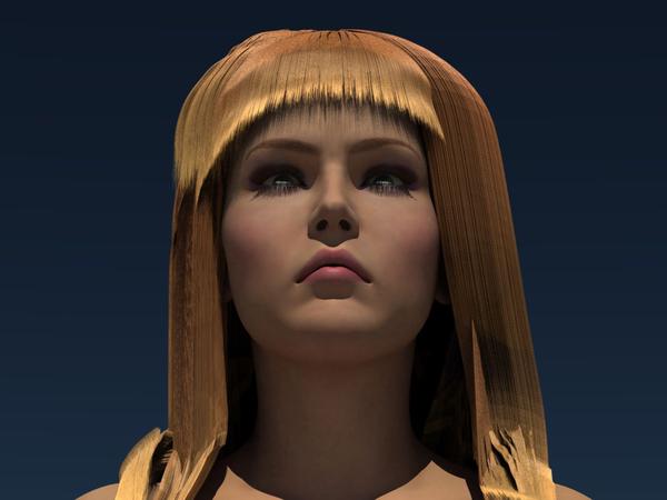

For the past two weeks, I have been trying to use the Hair room in Carrara to create some hair for a render that I am composing. The image is based of the cover of the Artpop Lady GaGa album, and I have attached a crop of the picture, as well as two different attempts I have done so far. I am not using any kink settings or shaders, just the main tools at this point. However, I cannot get it to look right. The ends are ragged, and the hair just won't fall the way I want it to. Any advice will be greatly appreciated :-)

    Here's where modeling in the assembly room can really help. Try adding a vertex object, and keeping it really low poly - then shape it around the head somewhat resembling the smooth shape of how you want the hair to actually land. That's a bit of a cheating way that I can think of. I used poxy figures made by Phil W (comes with advanced training course) and shaped it to ensure that the hair never drapes where I don't want it to. Now onto some other stuff:
    3DLust has taught me that messing with the gravity settings can help for animations, but It sure doesn't look like you need more gravity. But on that note, you can add subtle forces to your scene and have your hair set to be affected by it. I had some pretty cool results using forces. Especially if you're going for a still - because you could, perhaps, set up a simulation and pick the best frame of them where the hair looks best. Even without forces, if you lower your character, physically, over a couple of frames, you might get that extra body lift you're looking for.
    I've read where people had some great success with using "Push" in the hair room, but I could never get it to do what I expected - but I must admit that I ended up loosing patience. I guess that you can actually work on styles after draping. Push from the bottom up might work as well.

    Since I take it this is still image, you don't really need to drape the hair, or at least it can be styled after draping. That's the only way you're going to get the ends the way you want.

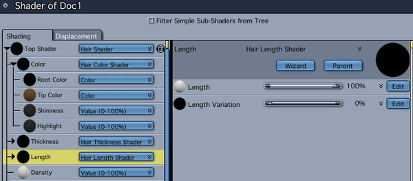

    Also, you will want to open the hair shader and look at the hair length shader and make sure it is off, or that it is set to no variation. Personally, I would make sure it is on, and the length is set to 100% with 0% variation. That way you know that you are forcing the hair to be even. My tests looked positive. You'll need to either up the density or size of the hairs to fill out the bangs.

    If you make her fringe (bangs) a bit longer, you can untick the generated hairs box so you only see the guide hairs. Then select only the fringe so you don't mess up any hairs on the side, and use the scissor tool and run it straight across the front so all guide hairs are the same length. Pull them into place with your mouse, not the brush and I don't drape. See below.
    Add extra guide hairs for thickness and extra segments for smoothness and use the "even segments tool" in the toolbar (the one with the little "o" in in. That should help with the boxy look towards the ends on the shoulders. If you "push" just do it the smallest increment you can put in the push box tool, just to lift the crown for a natural look. Too much push given an uneven crown. And pushing without adding segments makes more boxy hair bends.... which I have struggles with a lot! I never ever use drape anymore, I keep the generated hairs hidden and style the guide hairs using my mouse, pulling, curving, etc. I even avoid the brush when I can. The mouse on the guide hair lets me move one or more hairs in the direction I want. And if you have Pro you can use symmetry, but I don't. I want natural hair.
    And as EP said above, be sure the hair length shader is OFF and that the thickness shader is OFF as well. Once trimmed you can then decide if you want to make the roots a wee less than 100% thick... for a more naturalural progression from root to tip. Even the top might need a wee reduction.

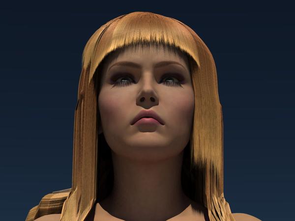

    Thanks sooo much for the advice. I purchased and have been watching the Phil W Tutorial (not the advanced one), and working on this image for the past couple of weeks. It took me several days to get the posing just right, and I found that directly manipulating the values under "motion" directly was easier to get the exact angles I was looking for. Once I got the pose just right, I purchased and used the terrific Olympia Carrara Shaders, and then decided to do the hair. I was unable to find a pre-built hair that had the look I wanted. I am not trying for an exact match to the reference, but I do want the bangs and general shape. I was not aware that the shader modified the hair length and variation I assume makes the hair length flux. I guess I need to go back and re-watch Disc 3 LOL.
    I have been having issues with styling the hair, as the brush tool always brushes it into the mesh, and when I use "Push" to fix it, it adds kinks and other "frizzies." I am wanting that straight look. I am going to try evilproducers suggestions first, and mess with the hair shader. I am afraid that Dartanbecks' suggestions jus went over my head LOL.

    When you drape the hair (if you drape the hair) you have physics follow the rules that you've set up for how stiff the hair is at the root, throughout the rest, and how well it retains its current shape. You can hit the esc key to halt the drape, and keep it anywhere along the drape process. This is my technique for getting my overall shape of the hair. Once it drapes close to the shape I want, I hit esc, and change the settings to help hold that shape.
    In Phil's Advanced Training, he covers the idea of using a Proxy model for your hair. The Proxy is basically the same shape as V4, but has a lot less polygons. He gives you two versions of the Proxy: One that you use all by itself, and one that, instead, you conform to V4 like clothes. So then you set up V4 to NOT collide with the hair. You do this with the clothes as well. This has the affect of giving the hair much less to calculate for collisions, which is what it does during draping.
    He also gives you a face shield that you can use to help keep the hair from simulating into and over the face - if you want to use this sort of thing. It's really well thought out, and his instructions are very cool!
    So anyways, using this idea of 'giving the hair something else to drape upon' - something that will actually be invisible in the scene, I have tried to pretty good results making simple models shaped around the figure in the shape in which I want the hair to lay after a drape.

    After months (and months) of playing with this, I ended up finding (and purchasing) a pre-made non-dynamic hair that works (mostly) for my original design. So, I am putting this render to bed (so-to-speak), and plan on starting my next project. I still am going to try and get a hang of the dynamic hair, and I think that the best solution is to attempt to place the hair guide-hair by guide-hair into place, vices using the automatic tools. This sounds tedious, but I am not sure of any other way maintain control over every strand. The biggest problem I am foreseeing is going to be that I am not a hair stylist LOL. I am posting my final render into the gallery. Thanks so much everyone!
