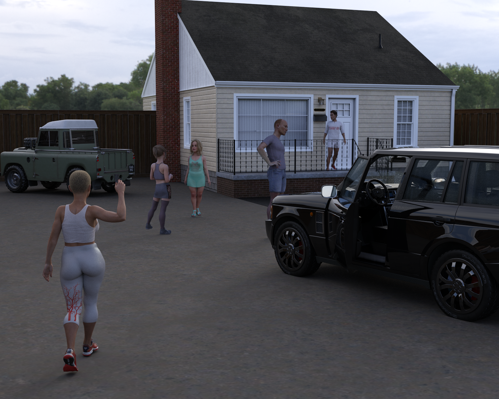

    Just to add to my last comment, I tried it and made myself a bunch of character billboards for use in the background. Great fun but I still need to find the knack of having the feet look like they are planted on the ground. In this scene only the one foreground figure is "real" - the rest are my billboards.
    1600 x 1280 - 3M
    Post edited by marble on
  • @Marble, seems like a delicate balance between camera angles and poses. I haven't figured that out yet either.
