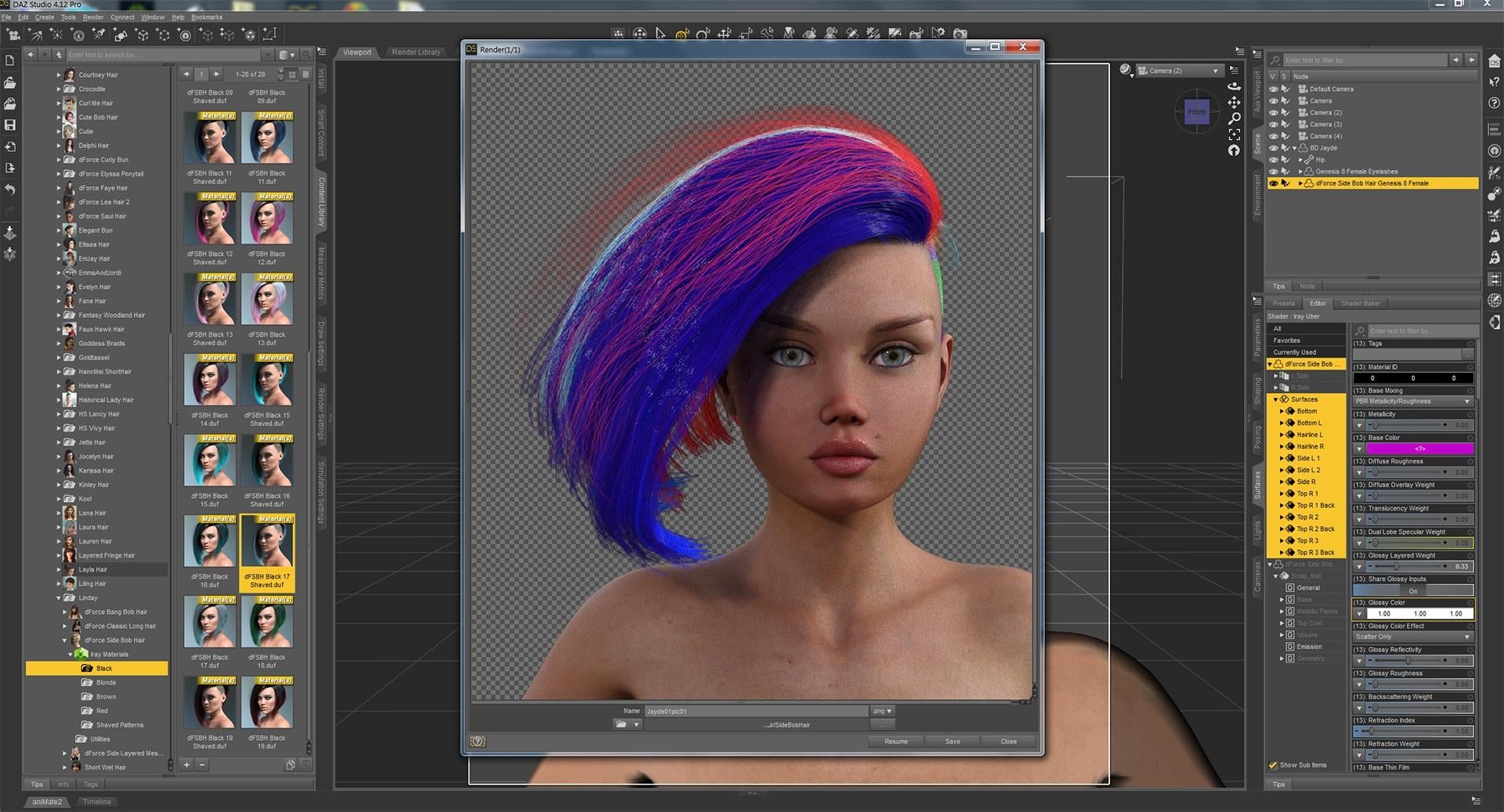

    Yes, it is the most bizarre hair, I have ever purchased.
    dForce simulation works well, but any preset, I have tried, gives me that:
    How do I get actual preset colors to appear on the render?

  • ArtiniArtini Posts: 11,023
    Thats strange. I have been able to apply color, I just cant render without crashing daz. Ive also had no issues with simulation itself. You cant apply any of the color presets at all?
    It looks like, so, but have not played with it any further.
    If Linday would drop the explanation, that will be great.

    Yes, I have following instructions, but hair does not render correctly (only showing colored material zones):
    1. Load dForce Side Bob Hair
    Hair is loaded with layer color display as default. It’s useful for adjusting
    movements and visible simulation result.
    2. Apply Global Simulation Preset. This Preset adjusts type of collision to Best, Start
    Bones from Memorized Pose to off, and Gravity to 5. Gravity is very important for
    simulation results. Dynamic Hair Settings are set to use high number of Gravity.
    3. Pose character, avoid collision with body or cloth and use Movement Morphs if
    needed.
    4. Run simulation and stop it when the haircut looks as expected.
    5. Apply Color Preset.
    6. For better light adjusting use PR Hair Viewport On Preset to see hair in preview
    render.
    7. If hair looks good enough for final rendering, use preset PR Hair Viewport Off,
    ‘cause when PR Hair Viewport is on, it is consuming a lot of RAM.
    8. Render
    Even worse, when I try to apply any other hair shader material, I have,
    it also does not work.
    Useless hair for me at the moment.

    @Artini , I think you might be applying the material to the wrong part (what you see in your render are the sim mat colors). The materials need to be applied to the "dForce Side Bob hair base" which in under the "dForce Side Bob hair Genesis 8 Female" in the list. Works fine otherwise over here. No memory problems, but it does use ~3.5Gb on my RTX2080ti (that includes a naked V8).
    Ciao
    TD
    Just tested, no change.
    I am using Daz Studio 4.12 Beta.
    Could that be a problem?
    Artini said:
    Just tested this hair with 4.12.0.83 Beta.  This is resulting render below.  Was just a quick out of the box with (1) hair color updated from multi-color preset and (2) stiffness changed for this pose.
    When you apply the hair colors, you need to be in Surfaces tab with dForce Side Bob Hair base selected in that tab, then click color of your choice.  Many mats only get updated that way, as opposed to from the scene tab.
    1920 x 1080 - 3M
    edited October 2019
    No change for me in Daz Studio 4.12.
    None of the color presets works for me.
    1920 x 1037 - 615K
    Post edited by Artini on
  • Expand the hair figure in the Scene pane - that is a skullcap and the hair is attached to that, that child item is what needs to be selected for the materials to work.
    edited October 2019
    Thanks. Finally get it to work.
