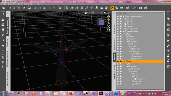

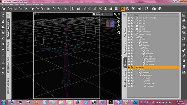

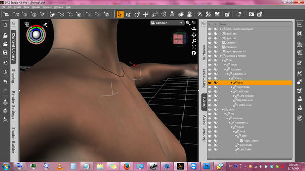

    ok so here are images of what I'm trying to do. I made a child bone coming from the 'neck' bone of the necklace and then parented the charm to that bone... and it is still not doing right.

  • Richard HaseltineRichard Haseltine Posts: 111,325
    edited January 2014
    How is the new bone affecting the necklace? My suggestion would work (if it would work at all) only if it affected it 100% at the point of attachment, so that the bone moved the necklace and the charm equally, with the influence fading out as the necklace got closer to the sides of the neck where it can be expected to match the movements of the neck. Essentially I'm saying replace the chest's influence with the new bone.
