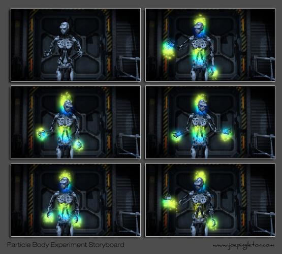

This is another experiment with Carrara Pro eight point fives particle emitter attached to a DAZ figure. The particles collide with all parts of the figure and the figure is animated with a motion capture aniblock from DAZ Studio converted to a nonlinear animation clip. I think it works better than the last experiment.

633 x 570 - 115K
