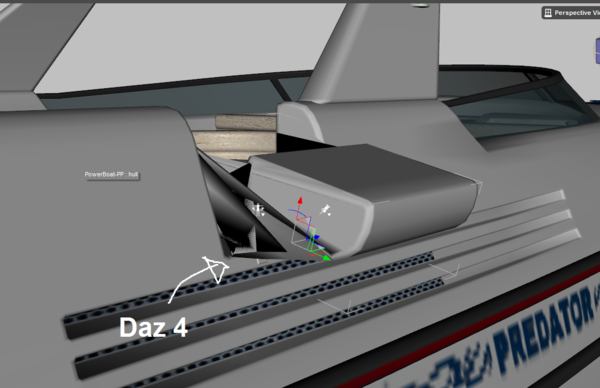

I discovered this problem.
BCManBCMan Posts: 17

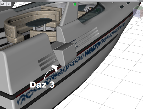

When I clicked onto the powerboat in Daz 4 I got this issue but when I entered Daz 3 it was normal.
My question is how do I correct this problem to get it working in Daz 4?

  • Richard HaseltineRichard Haseltine Posts: 111,984
    The problem is that the door are not separate from the hull - DS3, and Poser, break imported meshes into their groups and then stick them together according to the CR2 but DS4 loads the mesh literally. With luck you may be able to open the OBJ file - Runtime\Geometries\S Studio\Transport Figures\PowerBoat\PowerBoat.obj - in a modelling application, select each door, cut, and paste back in then save that back out and have it work; the vertex order will change, but since there are no morphs that doesn't matter - the risk is that the UV mapping will be lost so make a copy of the file before altering it. I'll point this out..

  • BCManBCMan Posts: 17
    Guess what I found the problem.
    It turned out that back when I installed it, when I was new to DAZ, I didn't download the Poser file that went with it.
    Now it's working fine.
    Thank you very much for looking at my problem.
