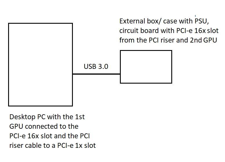

    I have a Desktop PC, but I don't want to put the second GPU into the MB because I like the idea to just connect it when it is needed.
    I'd like to use this
    https://www.amazon.com/Mining-Express-Adapter-Extension-Ethereum/dp/B079SL7YDW/ref=sr_1_9?crid=135C6DAN0BLYK&keywords=pcie+riser&qid=1569608929&sprefix=pci,aps,251&sr=8-9
    to build something like this
    775 x 560 - 60K

  • Won't work for multiple GPU's unless you buy an enclosure built for such or you can code and burn firmware to handle the PCIE to USB connection between multiple devices.
    The way mining rigs work is they use riser cables plugged directly into x1 slots on the motherboard and just house the GPU's and PSU's on some sort of open air rig. And that's an awful lot of messing about to add one GPU.
    If you onl;y want to add one just install it in your desktop. When you're not using it it will just sit there idle.
    If you want to buy a bunch of 1660's or the like and run them as some sort of dedicated render box then:
    Get something like this:
    https://www.amazon.com/Aluminum-Mining-Case-Frame-ZCash/dp/B073SMF21G/ref=pd_bxgy_147_img_3/136-4306729-0887323?_encoding=UTF8&pd_rd_i=B073SMF21G&pd_rd_r=cd9459b8-ab03-4c4a-b4aa-3dcfc56c3d46&pd_rd_w=0J9ps&pd_rd_wg=Cjgkm&pf_rd_p=479b6a22-70ae-47a0-9700-731033f96ce8&pf_rd_r=TD79SSJ52SCEFJ71RA4P&psc=1&refRID=TD79SSJ52SCEFJ71RA4P
    This:
    https://www.amazon.com/B250-MINING-EXPERT-Motherboard-Cryptocurrency/dp/B075KFPJ6M/ref=pd_cp_147_3/136-4306729-0887323?_encoding=UTF8&pd_rd_i=B075KFPJ6M&pd_rd_r=93201cd4-b09d-4ff5-bfea-7a2e2caa174e&pd_rd_w=nF063&pd_rd_wg=LPOcZ&pf_rd_p=ef4dc990-a9ca-4945-ae0b-f8d549198ed6&pf_rd_r=ZPFS7X5PX694697QKSMY&psc=1&refRID=ZPFS7X5PX694697QKSMY
    And this:
    https://www.amazon.com/Intel-i7-7700K-Desktop-Processor-unlocked/dp/B01MXSI216/ref=sr_1_2?keywords=i7+7700&qid=1569614896&s=electronics&sr=1-2
    Which should support up to 8 GPU's for iRay rendering. You'll need a couple of decent PSU's (wattage won't have to be super high but get the best 80+ rating you can as drawing this much power enough to make rig like this worth the cost will hit your power bill so efficiency matters.)

  • MazhMazh Posts: 495
    edited September 2019
    Thanks for your answers.
    I've thought I haven't described my plan that bad, but I can try to get a little bit into details.
    I've planned to:
    1. Buy one of these riser cables I've posted earlier, price < $10
    2. Buy an used desktop case with PSU, price < $10
    3. Since the mining hype is over, try to get an used mining GPU for a good price, maybe from a vendor with limited warranty, price ~ $100
    4. Build it exactly mining rig style (with the option to connect/ disconnect the rig as needed, for power consumption reasons - my actual GPU is good for the most rendering tasks, except hugh scenes and animations), and -
    5. if it works out well, have the the option to repeat step 1. + 3. once/ twice more.
    And there's another reason to NOT be messing around with this kind of a setup.  "Connecting and Disconnecting" a GPU manually/physically will increase the risk of damage to the card, motherboard, and cable components and connections.  Anything from a clumsy thumb breaking off a capacitor or connection tab, to an unlucky day where you inadvertently zap your card or motherboard because you were carrying a little more electricity with you after petting the cat or walking on the carpet.
    Your plan may sound clever, but this would basically be "a tweak".  Stop teaking, people; you'll do more harm than good!  There, I said it.
    And of course I've never planned anything like connecting/ disconnecting GPU cards as needed (since there are USB connectors on the riser circuit boards to do this), where did I write that ?
    I would even build a solution to keep the USB connectors on the riser circuit boards (the cute 1x and the big 16x) free from connecting/ disconnecting stress.
    But to follow your advice and keep it simple, I take back my original question and ask the following instead:
    Does a mining rig works exactly as a render rig for DazStudio/ is DazStudio capable to use a mining rig for rendering - and I guess this is already answered by kenshaw011267.
    I apologize for sharing my thoughts and reasons with you.
