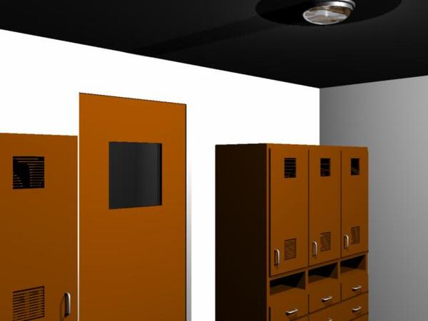

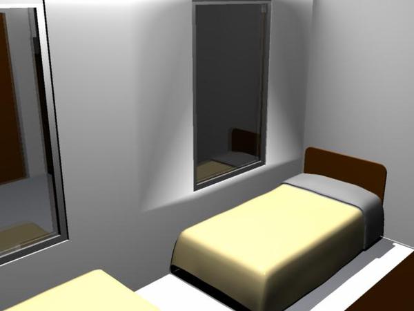

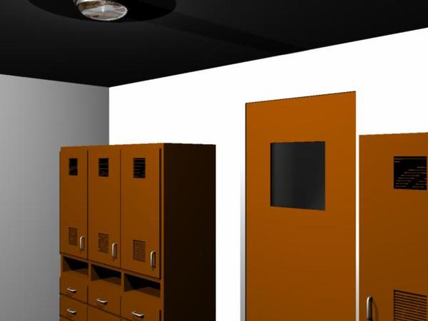

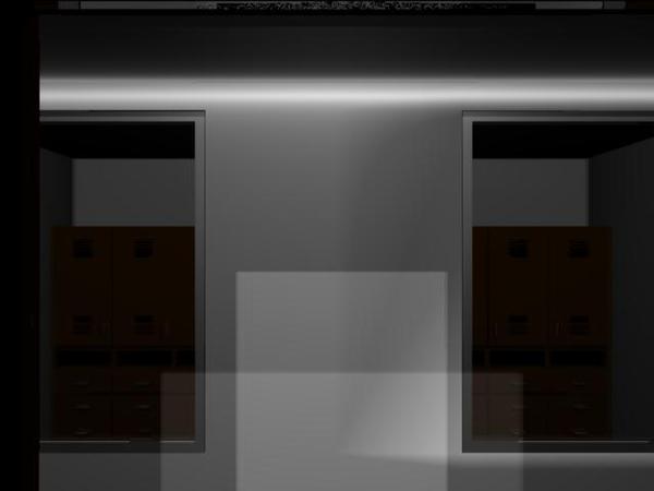

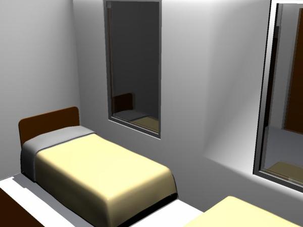

I’m working a dorm room with real world and scale 10’ x 15’ 6” with 8‘ceiling, it’s currently layout just to give the feel of the room.
What I need help with is the lighting which is just a bulb (bulb light) in the center of the room at the moment. My goal is to make it as realistic as I can.
Later on I’ll need help with making the walls look painted & how to get the wood to look correct for the piece.
(it's a night scene)

    What is the goal for the scene? An animation, a still render?
    Looking cool so far!
    Many might disagree with this technique, but I'm throwing it out there anyways in case you might like it.
    For light fixtures, like the one I see on the ceiling, I prefer to use a spot light instead of a bulb. Then I set the angle to 90 and the angle falloff to around 30. Then I'll set the distance to 30 feet with a falloff set high, like 60. Distance and falloff for distance need tweaks according to the room and what sort of effect you want. But now we don't have any light on the ceiling. So I duplicate the spot and flip it, reduce the distance and brightness. Both of these lights need to be low enough to not touch the mesh of the fixture, unless you set it to ignore the fixture - I prefer to just place the lights below the fixture. Note that you can get closer and closer to objects the smaller you scale the lights.
    Really like your modeling though. The scene is really looking great!

    I'm planning on using the scene/set as a still for the time being with the hopes of using it as part of an animation when/if I get the other pieces done. The beds aren't my work just fill-ins until I get things done.

    each surface will reflect light at a certain colour so that is something to think about - also caustics for the mirror
    this reflected light will effect shadow colour as well

    you could also try making your room an anything glows object with a small radiance eg 12 percent to get a base lighting - and see what happens

    For interior lighting, I think that it essential to use the gamma correction = 2.2 so that you are working as much as possible with a Linear Workflow (see http://www.daz3d.com/forums/discussion/25644/ if you haven't been following that discussion).
    My other recommendations would be to ensure that the Ambient Light brightness is set to zero, use full Indirect Lighting which will model the light bouncing off objects in your scene (it's faster to render than you may think if you haven't used it much). For the light sources, I have had a lot of success using models with glow turned up (so use the 0-10000% slider and set to between 1000 and 10000%, multiply by a color if you want a colored light). (Note this only works with Full Indirect Lighting turned on). A light bulb can be a simple small sphere unless it is to be seen close up, when a bit more modelling may be in order. Place this where any real bulbs would be and see what that gives you. If you are getting dark blotches in your lighting, turn up Lighting Quality in the GI panel to Best (again the render time hit is not that great).
