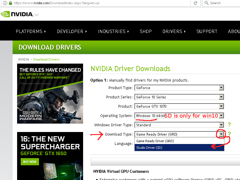

  • Studio Driver is the same as Creator driver - it's just a name change, perhaps Creator was cinfusing people who could benefit from it but didn't think of their software that way.
    edited September 2019
    ok, so Creator was migrated to the 'Studio' branch (maybe, in theory, a memo I missed somewhere?), thanks.
    because some may have missed the selection on the driver selection page (including myself)
    'Studio' the name - I always read 'studio' akin to a studio apartment, like a lower level 'prosumer' Standard Distribution (SD) level rather than the other direction of more verified tesla/VCA corporation/national-lab level, Nvidia did a tad more than letting consumers beta test the update first before calling it 'non-hazardous' (jab at win10). lol. I guess naming stuff can be difficult when ye can't just call it something that will get 'them' legally bound to testing they haven't done to something that isn't financially worth it.
    I even hesitate to say, I have yet to see a problem running DS4.12 on driver 419 for the past couple of hours with (long list of one possible computer config that probably no one else is running exactly the same thing), Yet, lol. I'm sure there is 'something' somewhere that the newer driver will support or make better. will try after I wake up with a cup of coffee.
    800 x 600 - 152K

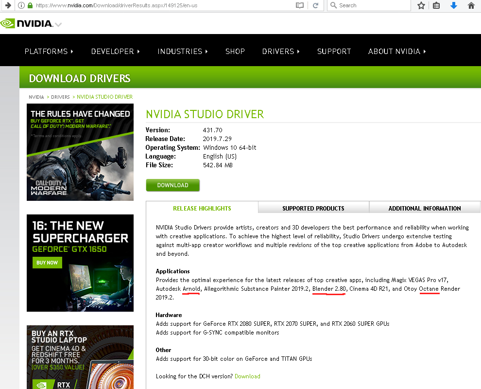

  • NorthOf45NorthOf45 Posts: 5,927
    According to my GeForce Experience app, the latest NVIDIA Studio driver available is 431.70, released 2019-07-29. There's even a blurb about Daz Studio 4.12 joining the list of those using RTX (must have been about the Beta).
    Interesting that doesn't show up with my list (shown above) when looking for SD drivers (431.86 is what the site gives me for win10/GTX1070non-ti/SD), DCH is also showing 431.86. I can only find it via searching externally to Nvidia's site to get to Nvidia's page for it. The page looks legit, maybe there still rolling it out (shrugs) or they rolled it back due to 'reasons', never mind, before coffee moment, 70 is before 86, lol.
    (Weyland motion tracker sound) "Sir, this place is dead. Whatever happened here, I think we missed it." - Sgt. Apone.
    welp, if anything will make me not interested in an 'SD' driver, it's a complete lack of iray being mentioned, anywhere, lol.
    Guess I'll give 431.70 a try as it at least has some 3D apps listed. Thanks, NorthOf45.

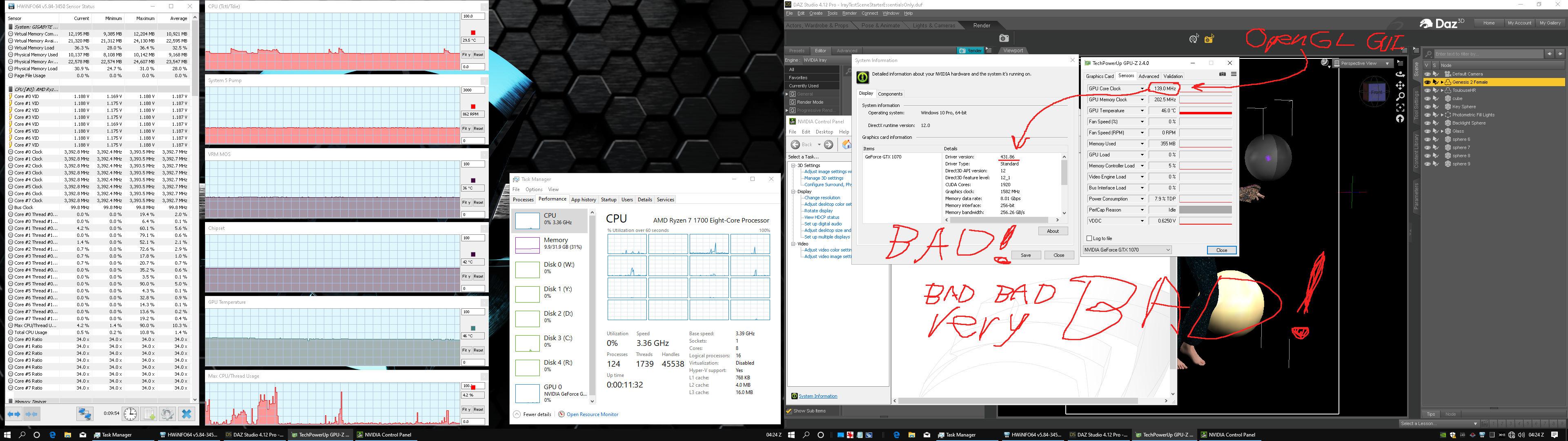

    hmm, can't seem to get to safe mode to DDU the old driver, F8 appears to be busticated on win10 now (heads off to slam-baste M$ for breaking win10, again)

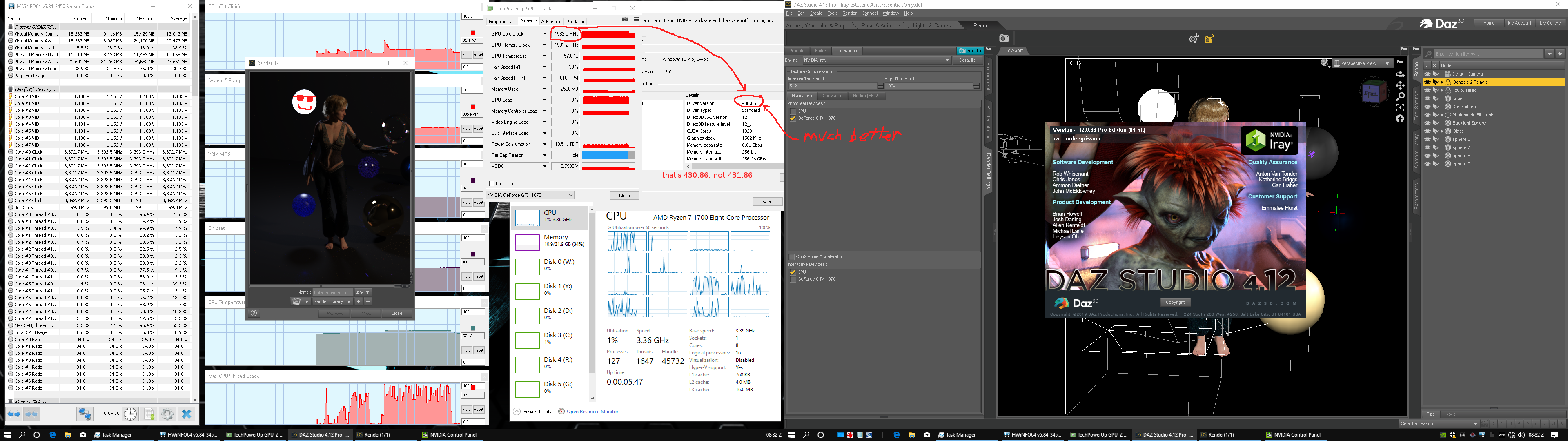

    Edit. looks like 431.86 is a BAD bad bad idea to install. it's gimping the GPU to 139MHz comatose mode for non-directX loads (OpenGL GUI in DS).
    a GTX1070non-ti should be able to do more than 7FPS in the viewport with OpenGL, my GT730 does better than that, lol. (second look at 431.86, looks like you can force it into a high clock mode, and rebooting the computer is necessary for that high clock all the time mode to take effect)
    looks like 431.70 is just as bad. Gues we are back in the days of running Unigine Heaven DirectX Benchmark in the background just to be able to use the OpenGL GUI in DazStudio. NEXT!

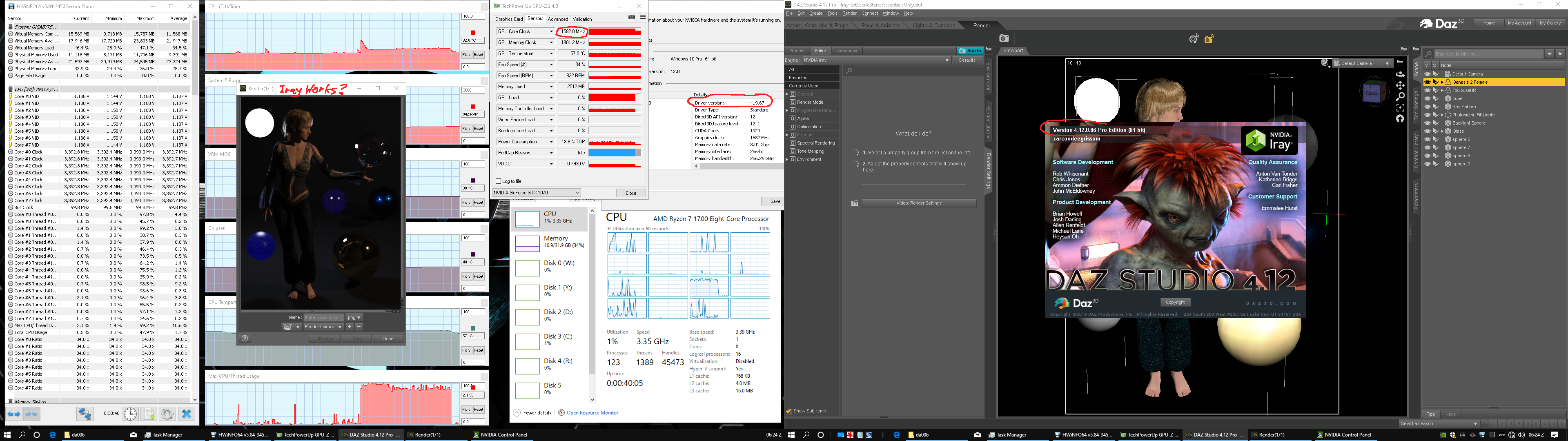

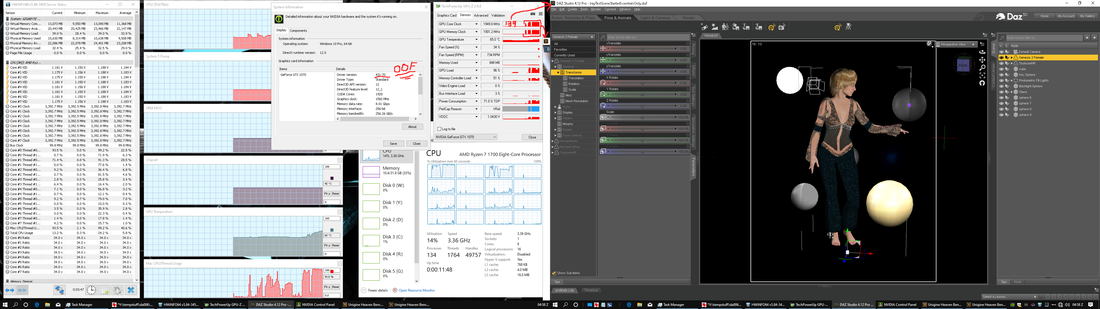

    Studio Driver v430.86 test pending. (that was the one that had Daz Studio and Arnold listed in the notes)...
    does normal clocks, so long as you set the power profile to 'maximum performance' mode, and a reboot is necessary to kick in the non-comatose settings. ... I need to retest 431.86, I don't remember if I rebooted the PC after setting 'maximum performance' mode, I know I did a few times for 431.70.
    P.S. and yes, I am aware of the Power profile thing, I tried it already with all of these drivers.
    Only the Creator Ready Driver v419.67 appears to be kicking clocks up properly for Daz Studio's OpenGL interface.

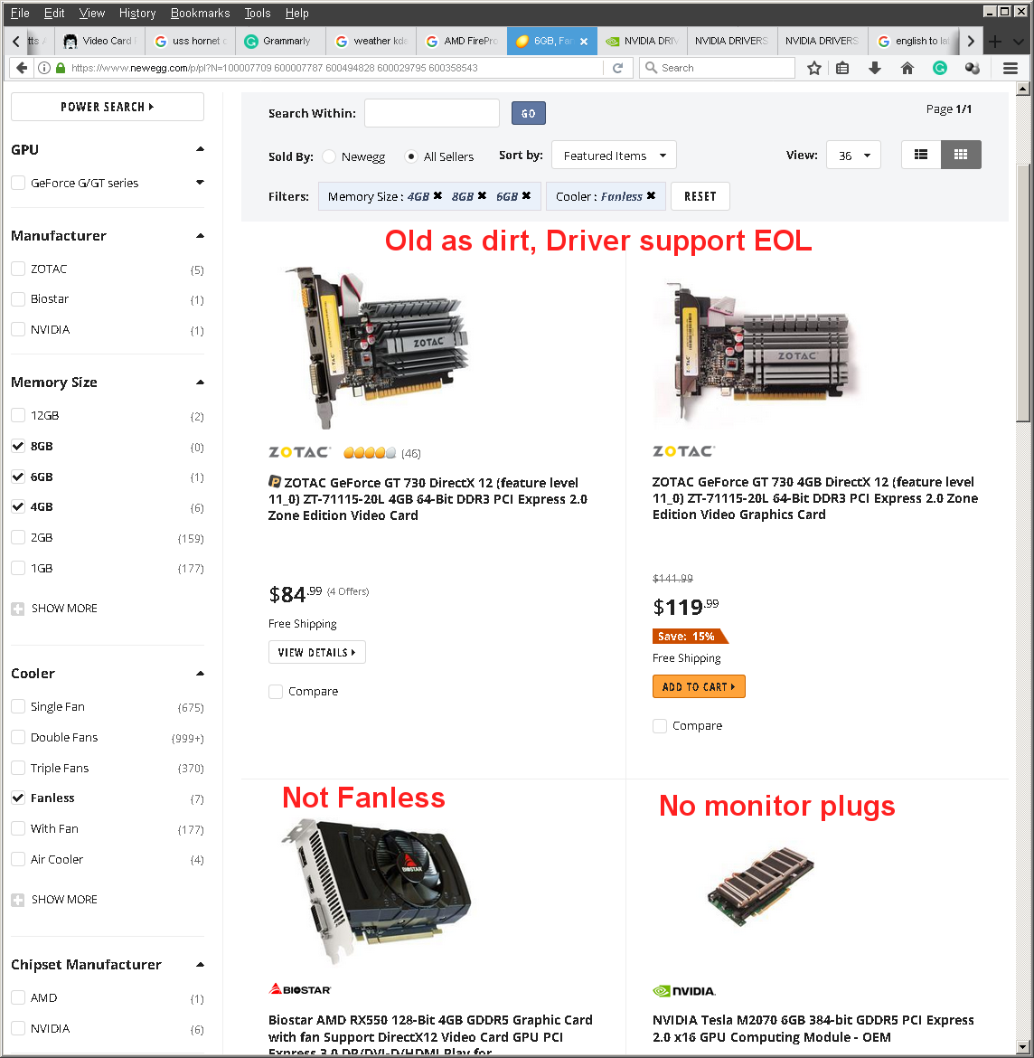

    I have a plan, that has been fermenting in the back of my mind for some time. I've wanted to migrate the GTX1070non-ti over to a secondary dedicated CUDA/Iray only compute card for some time. Because Nvidia appears to be incapable of putting 4+GB of memory on a low watt card of late, and their OpenGL performance is incredibly lacking. AMD also appears to be rather lacking in the low watt cards of late as well (a 180watt RX570 isn't exactly less than 50 watts that can be passively cooled, lol).
    I would consider the GTX1030 (GTX, lol), IF, if it had 4GB, it doesn't. I may see if I can find a 30watt ATI Radion 7000 card that is PCIe instead of AGP or 32bit-PCI, to drop in the GN R7 comp to drive the monitors, just for the hell of it and for spite, lol.
    (sarcasm detected) Because clearly, Nvidia does not want me using their stuff for driving monitors, lol.
    I should take this opportunity to Thank DazSpooky for suggesting the 4GB GT730 eons ago. The thing has the minimum 4GB so if an app wants to do something with CUDA it doesn't tell me to go pound sand. It's fanless and dead silent making it perfect for the DAW/HTPC, and it's low watt reducing the need for case fans to rev up in the middle of playing movies on the DAW/HTPC. I really am happy with the GT730 (GK208) 4GB card, because I'm not being a fool and trying to make the card do stuff it was never meant to do.
