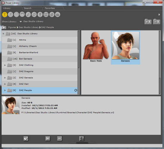

    edited January 2014
    Do you have your Daz library also mapped as a Poser library in Poser?
    832 x 757 - 219K
    Post edited by Lissa_xyz on
  • RowlandoRowlando Posts: 0
    I think what you mean is dose my Daz and poser use the same folder ( Yes ) its in my documents folder called Daz3d/Content and everything is in there.
    I think thats what you mean by mapped yes?
    cheers
    edited January 2014
    Mapping is the process of adding a folder to Poser/DS as a library.
    If it is, then in Poser you should find Genesis in Library > Daz People. Be sure to have the figures icon selected (the far left one that's yellow in my screenshot).
