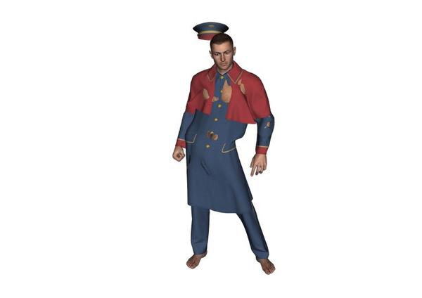

Problem to fit Door Man cloth to Michael 4!
I don't get the cloth to fit good on Michael for some reason
and don't know why!
I use the fit to command for each cloth part and looks like
trousers fit ok and hat but not the jacket!
I also tried to use the command "Transfer active morphs" but
nothing happened!
If I try to use a pose for Michael 4 it give more issues!
The suit does not fit good at all!
Any tip is welcome for a solution!
Check images how it looks!
I wish you all a good and creative year of 2014!
Alf
800 x 565 - 16K
800 x 565 - 15K
This is 'Dynamic clothing' made for M4 (by Optitex) using the DAZ Dynamic Clothing Control, and it will only work correctly inside DAZ Studio.
If you are using DAZ Studio (?), go to Window > Panes (Tabs) > Dynamic Clothing.
This item is a dynamic outfit, not a conforming one, and needs to be used with the dynamic cloth engine.
Thanks for the replies!
Yes, I am using DAZ 4.6!
Is it difficult to learn how to use Dynamic Clothing?
Any tutorials or info that I can read so I know what to do?
Alf
There used to be a PDF which came along with the DCC, and I have one among my manuals called:
'Dynamic_Clothing_Control_User_Guide.PDF' I am not sure where it came from though.
I also have another one called 'Dynamic Clothing Plugin.PDF'
Found this link for you : http://docs.daz3d.com/lib/exe/fetch.php/public/read_me/index/9032/dynamic_clothing_control_user_guide.pdf
You can also find some freebies here : http://www.optitex-dynamiccloth.com/FreebieDownload01.php
Thanks!
Got the manual!
There were two links in the redme file for the Door Man suit,
but the links don't work!
Dynamic Clothing Basic: http://artzone.daz3d.com/wiki/doku.php/pub/software/dynclothbasic/start
Dynamic Clothing Control!: http://artzone.daz3d.com/wiki/doku.php/pub/software/dynclothctrl/start
I am totally new to Dynamic Clothing and I guess it might be very useful then you do animation
and cloths follow the body well in motion!
The hat seems not to be Dynamic Clothing control working! Little tricky to get it on correct on head
then posing Michael! I will study the manual and see if I get it to work!
