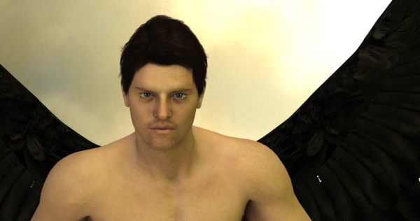

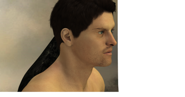

I've been working on this character for months and I decided to start revamping him and I still cannot get his nose right.
So I NEED HELP. WHAT DO I DO?
What parameters do I need to adjust or whatever? what needs fixing? etc. I know it looks WRONG but I don't know what to do about it.

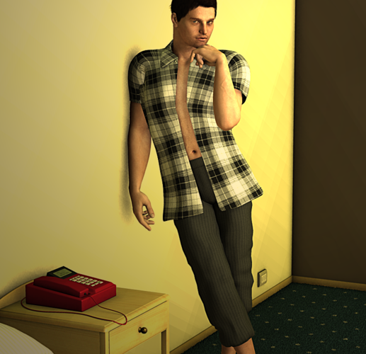

The first...or last one, depending on the order, where he's wearing the..pajama shit, is before the revamp. I still have that face but I'm getting real sick of messing with it.
and i had to transfer it over to a completely separateM4, using the numbers from the paremeter dials so it's not like I can just 'go back' to the old one that easily.

For the nose, I'd say it looks too wide in the middle. Play with NoseBridgeWidth, and NoseRidgeWidth. The nose tip looks too low. Try NoseTipHeight. Try adjusting NostrilsHoleHeight too.
The mouth looks too flat, too pushed in. Try adjusting LipTopDepth, LipBottomDepth (IIRC). Try to pull the mouth forward just a little.
