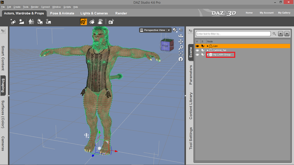

    and also i found that the LAMH group name also changes from "Lion LAMH" to something else when the bug occurs
    as shown in picture
    1366 x 768 - 308K
    Post edited by treeorents1992 on
  • Alessandro MastronardiAlessandro Mastronardi Posts: 2,659
    The autofit issue has been fixed in current WIP code, which should be made available as beta in next few days. I or Kendall will put a note here so that if you like you may try it.
