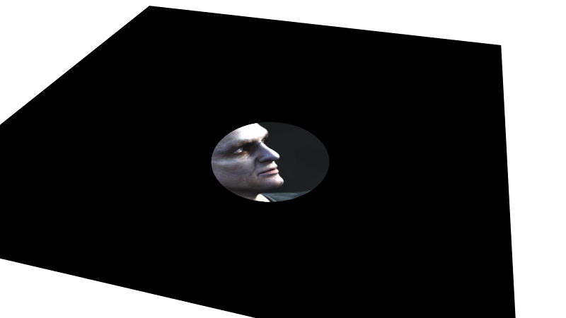

What i'm looking for is a circle of light with Hard Edge - not one that gradually fades to the outer edge. I will try your suggestion though - thanks!
An example I did in Poser a long time ago:
I think that's going to be difficult to achieve in Iray, which is trying to emulate real world light. I don't know enough about 3Delight to know if it's possible with that render engine.
I do have some ideas of how you can create the illusion of a hard edge. Can you be more specific about what you're trying to accomplish? Maybe I can help, if I know the end goal.
I just posted an example :)
Definitely possible in 3DL, with an AoA spot. I don't know enough about IRay to be able to come up with something specific, but thinking maybe it's also possible in IRay to use a mask or gel on the spot?
Quick test with a gel, you can scale and blur it if needed. This is with 0% blur:
In Iray, the trick is to make the geometry size as small as possible. A Disc of 1x1 is a good start. Remember that distance from light to background is also a factor. The closer the light, the sharper the shadow.
