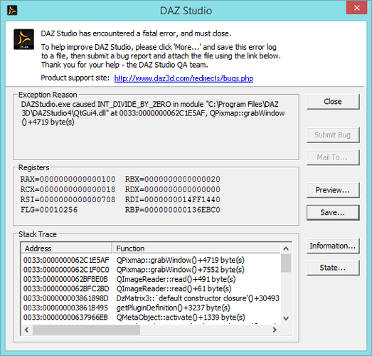

I've been using Daz Studio mostly problem free for several months now and have hundreds of successful renders. However, just tonight Daz Studio crashed. But now every time I try and start it up to an empty scene, it loads up about a third of the way and crashes!
The Exception reason stated is this:
DAZStudio.exe caused INT_DIVIDE_BY_ZERO in module "C:\Program Files\DAZ 3D\DAZStudio4\QtGui4.dll" at 0033:0000000062C1E5AF, QPixmap::grabWindow()+4719 byte(s)
I'm running this on a Nvidea GeForce GTX 770 which is no weak little card. I am launching 4.6 Pro 64-bit on Windows 8. Restarting my computer did nothing, and this happened after already having the program open for several hours so it is unlikely a windows update suddenly applied itself.
I did not add any content recently and no previous installed content has caused it crash before. As mentioned before, I'm just loading it up to an empty, fresh scene, so it's not when trying to load any particular asset.
Has anyone encountered something like this? I will attempt the usual things--update drivers, reinstall, etc, and have submitted a bug report--but if anyone else has encountered this and has advice I'd love to hear it. Thanks!

    If it is suddenly doing it I would suspect a driver update - nVidia do, I think, update without prompting by default.
    I did a little looking around, last night, and it seems this particular error is pretty common in gaming circles and many times does indicate driver problems...but NOT video drivers. It is many times caused by AUDIO driver problems.
    Depending on your computer...especially if it is an 'off the shelf' machine from a big name label, it can have all sorts of 'auto updaters', some of which can/will update drivers...so start checking to see if there have been any updated drivers, recently. Also, AV updates and OS updates can cause problems...

    This is what tech support has had to say so far--the suggestions are along a bit of a different line, stating that it may be a database issue. I'm unable to test at the moment, likely not until later tonight or in a few days.
    Hi,
    Thanks for the error log. It looks like you have a corrupt database. There is an involved process to fix that. However, before you do that, let's try something easy. I'd like you to clear out the DSON Cache folder, if possible. Normally, you could launch Studio and go to EDIT --> Preferences --> General --> DSON Cache Files. This would give you the path to the DSON Cache Folder. Since you probably cannot get DAZ Studio to launch and stay stable for that long, you should look for the default folder.
    The default folder for the DSON Cache folder is here:
    C:/Users/[your user account]/AppData/Roaming/DAZ 3D/dson/cache
    Find the cache folder and delete all the files and folders (if any) inside of it. Then try to launch Studio. If that works, it should be good.
    However, based upon the message of the log you sent me, I believe the real cause is a corrupt database. If doing the above doesn't resolve this, then you need to trash the database and re-launch Studio.
    Scroll down to REBUILD THE METADATA DATABASE. Please following these instructions carefully. If you have questions about what they mean, please ask before doing them.
    https://helpdaz.zendesk.com/entries/22523891-Trouble-shooting-the-Smart-Content-Pane
    Please let me know the status of this issue.

    What tech support suggested did not work.
    In addition, I've gone to my View update history in Windows 8.1, and there is no listed updated newer that one from the 14th. I've rendered dozens of images since then.
    In addition, I've gone to my View update history in Windows 8.1, and there is no listed updated newer that one from the 14th. I've rendered dozens of images since then.[/quote

    So as it turns out the culprit in my scenario was actually a particular plugin, dzrenderlibrary.dll . Removing it from my plugins folder allows Daz to load and--as far as I'm aware--operate as normal.
    Anyone know what dzrenderlibrary.dll is responsible for? It sounds somewhat important, but I've not--yet--encountered any problems running Daz Studio without it.
  • Richard HaseltineRichard Haseltine Posts: 111,306
    That's the render library - a pane which shows thumbnail views of the images in the folder it is pointing to, and automatically generates images even if the image was not originally a render. I imagine there was either a bad file in there that caused it to crash when DS tried to generate the thumbnail or something about the folder being pointed to.
    I wonder what it would do if the folder it was pointing to had a permissions problem or wasn't writeable?
    Quite, but I can't immediately see where the path is stored to allow it to be recovered for checking.
