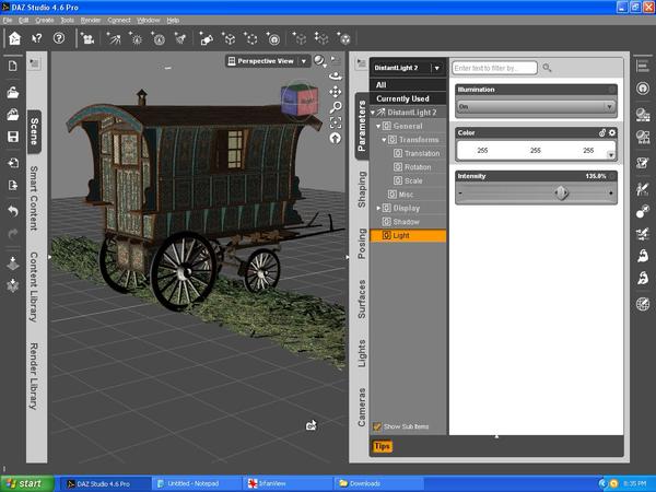

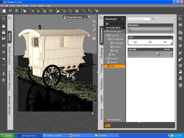

    Thanks for both your replies.
    This problem seems at the moment to be associated only to the prop I am using
    Boundless Journey , a horse drawn caravan used by travelers .Have tried other props
    without any problems.
    This prop comes with a light included which I did remove.without any difference to this issue.
    Two images here with two Daz distant lamps . One before render the other after.
    Please note the wheels and chimney and grass do not seem to be affected?
    Turning off the preview light from Window menu does not change things.
    The lights on but cannot find from where.lol
    Lowering the intensity has no effect.
    thanks Regards John

    That's not lighting - it's the reflection map. I thought those items had DS-native materials, but maybe not - in any event you want to lower the reflection strength and/or remove the reflection map; several of the older Redhouse sets suffer from that.
    Also make sure that you don't have the Ambient channel cranked up to 100%. Since (roughly) the ambient setting says "If no other lights are shining here, apply an ambient lighting factor instead", you can get some unwanted effects that way too.

    Well fixed the problem at last.
    Seems "you hit the nail right on the head" Richard. Reflection Maps.
    Having selected each item from the Scene tab going into the Surfaces and finding reflections reset that to zero 0% from 100%
    Spot render....Bingo all back to normal....Phew !!
